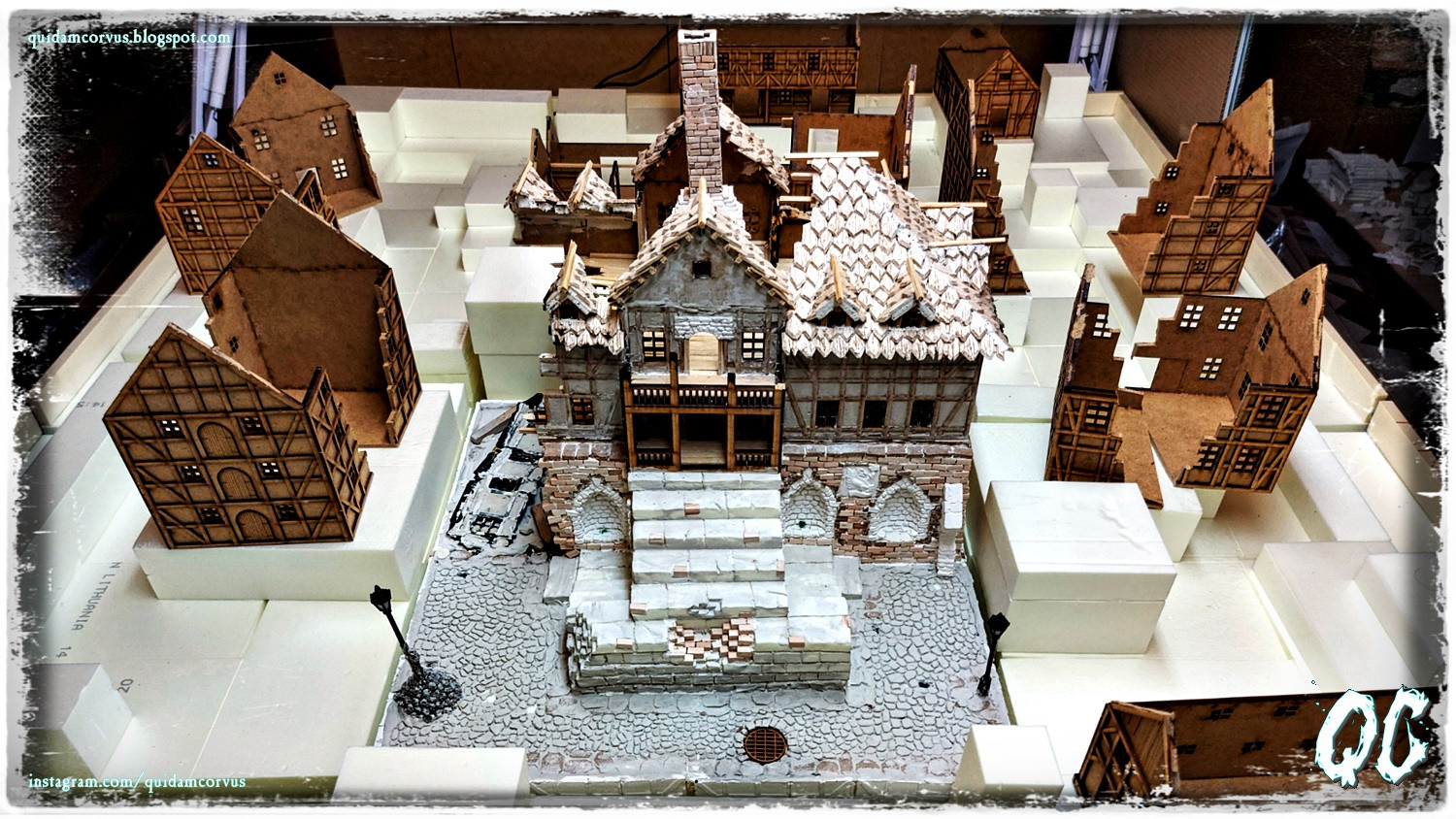

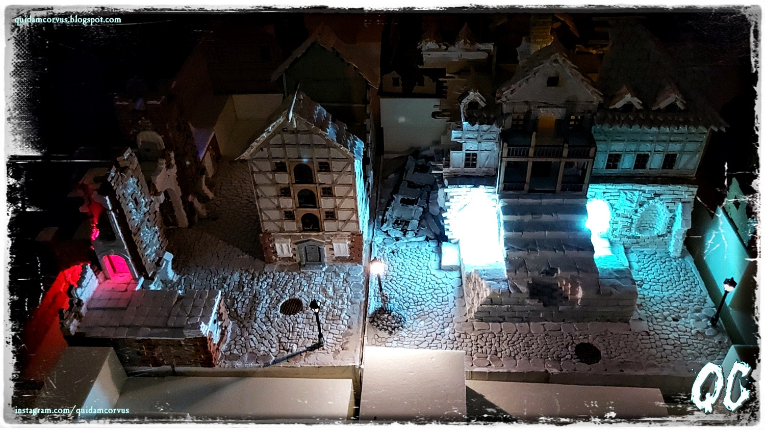

Workshop: Construction of the 'Ruins of Mordheim' modular table, part 7.

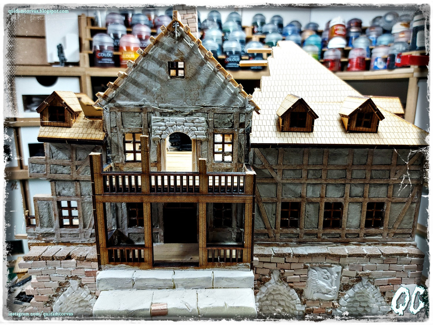

After completing the work on the foundations, I started filling the gaps between the building beams.
For this purpose, I used plaster of paris and used the same technique that I used in the construction of Teufeslberg, more about which I wrote HERE.

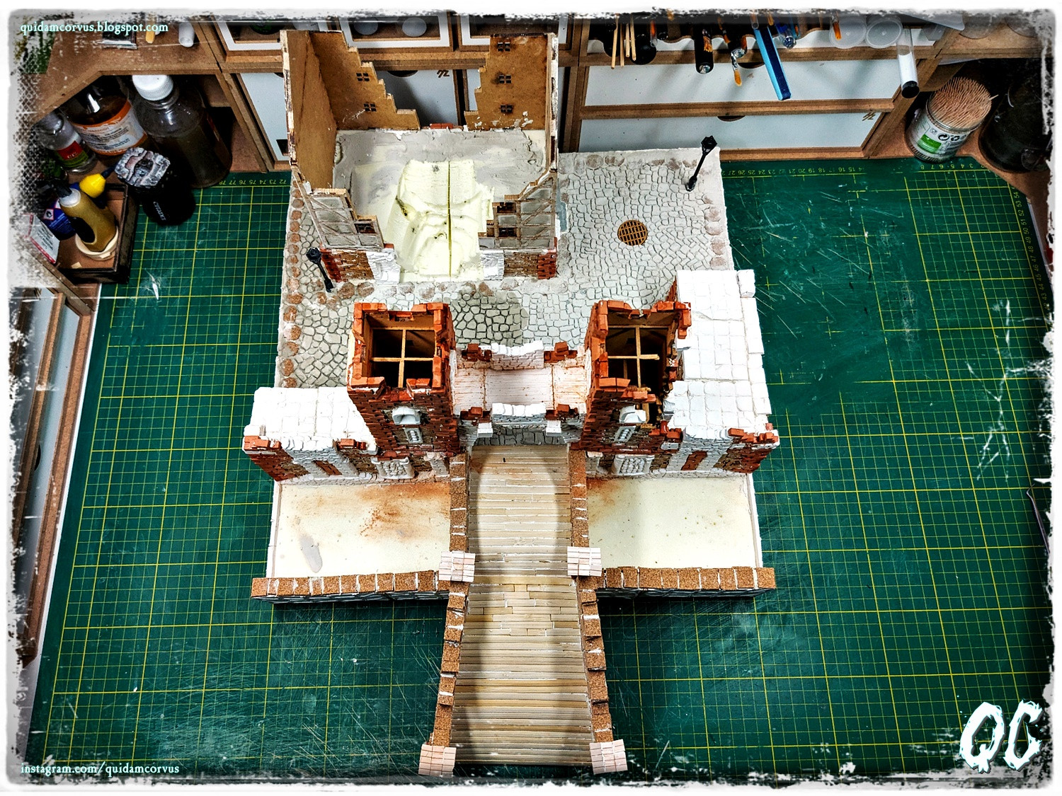

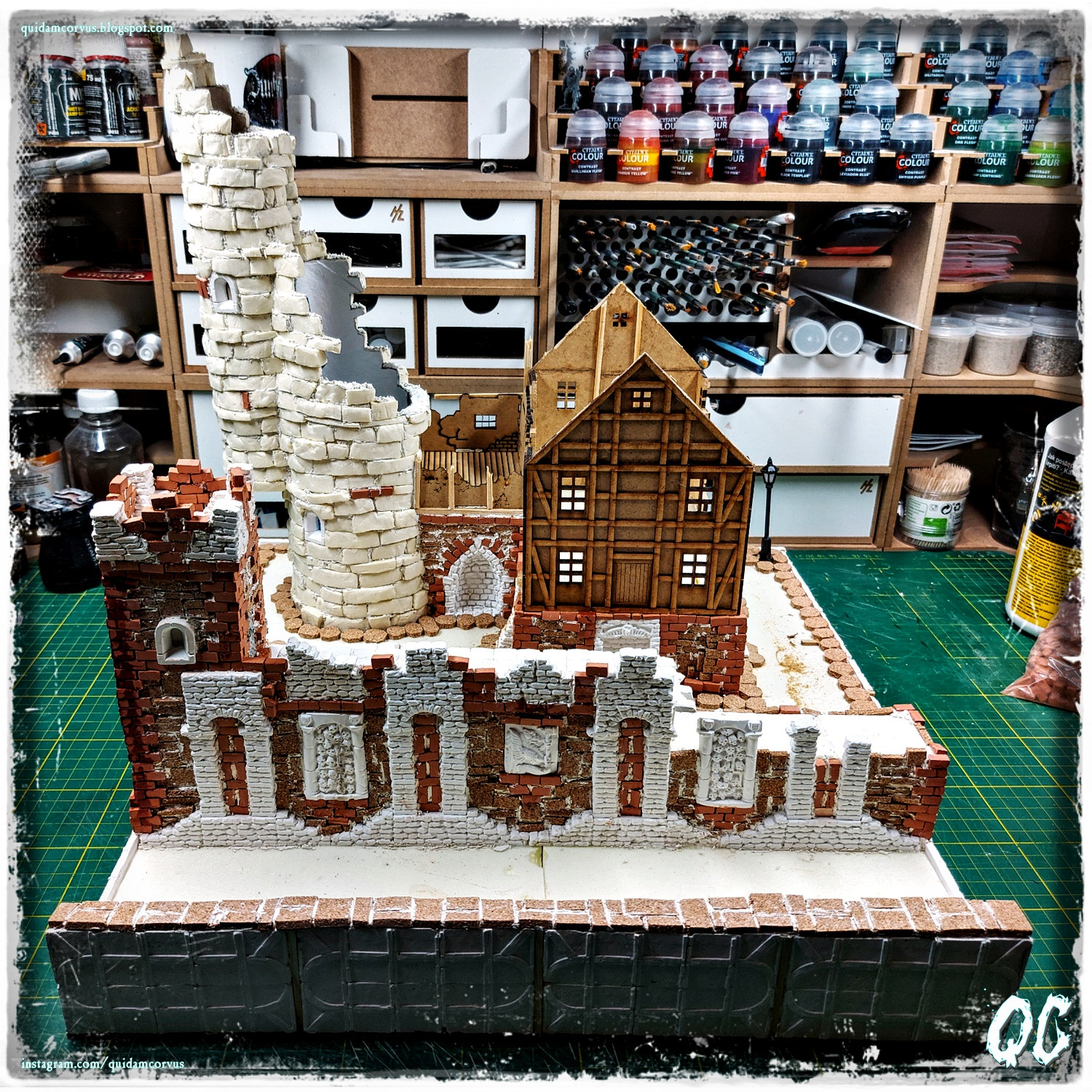

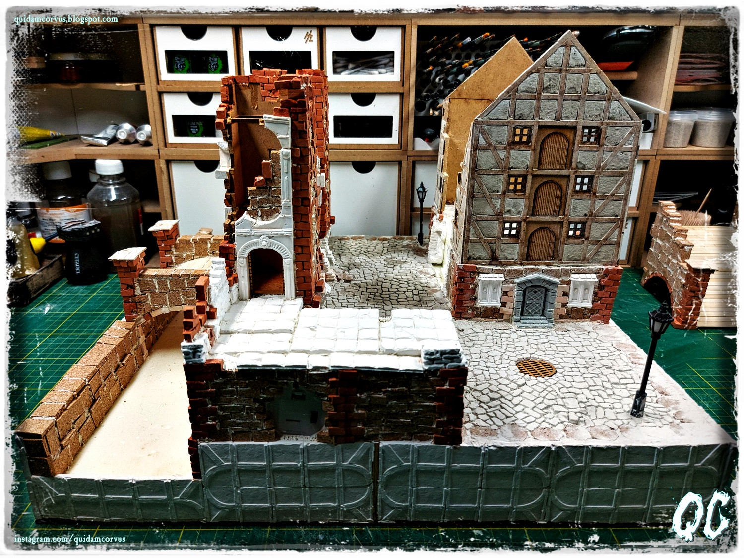

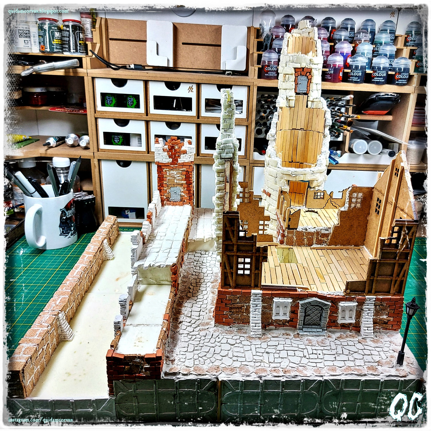

Workshop: Construction of the 'Ruins of Mordheim' modular table, part 9.

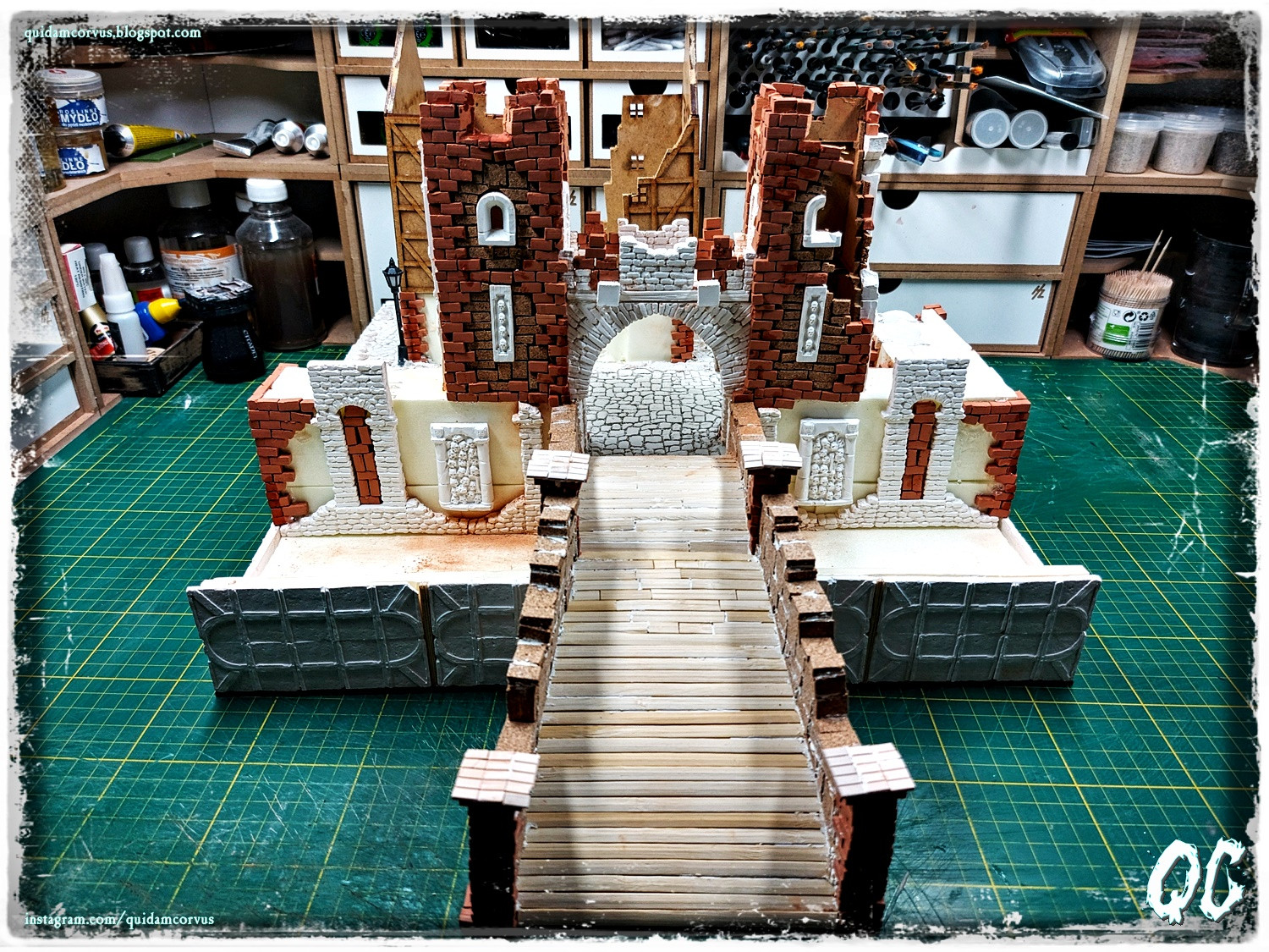

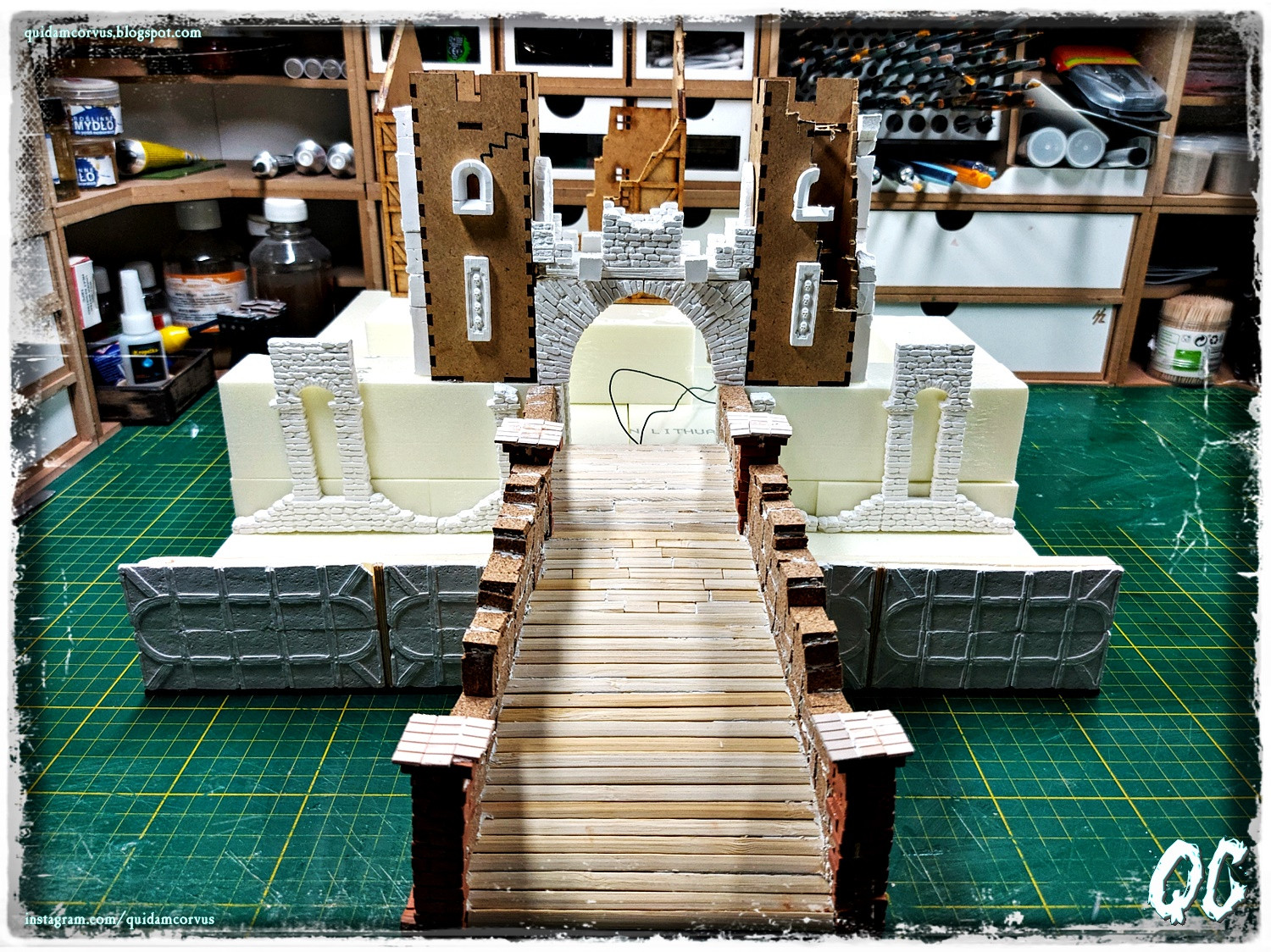

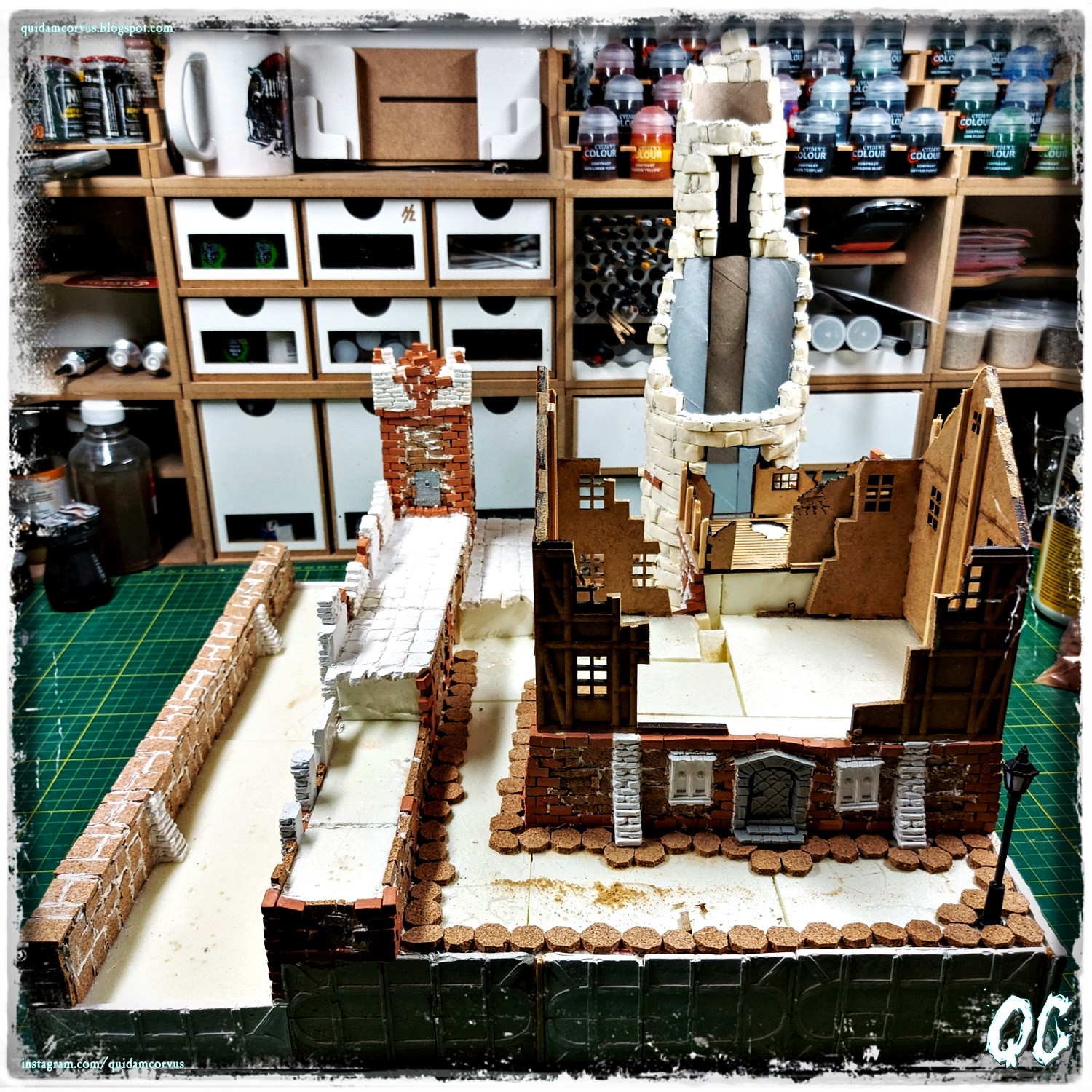

Two weeks ago, on the DansE MacabrE blog, I showed you the first module of the table with the ruins of Mordheim, completed, at least at a basic level.
Today I have photos for you of the second module I was working on.

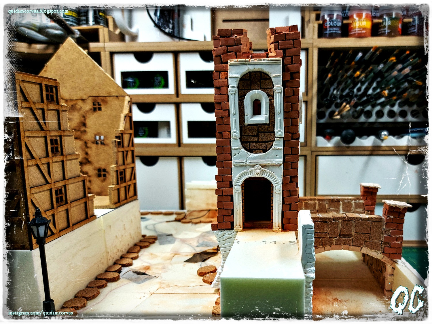

In addition to the ruined building model of the Granary from Lasercut Buildings company, the module also has a place for two towers cut from HDF by Karol and a bridge, which I built with styrodur, wooden slats, cork and plaster bricks bought in the Battle Models store.
The structural elements cast from white plaster are bits from Rotten Factory, and I have traditionally scratched the pavement in plaster putty.

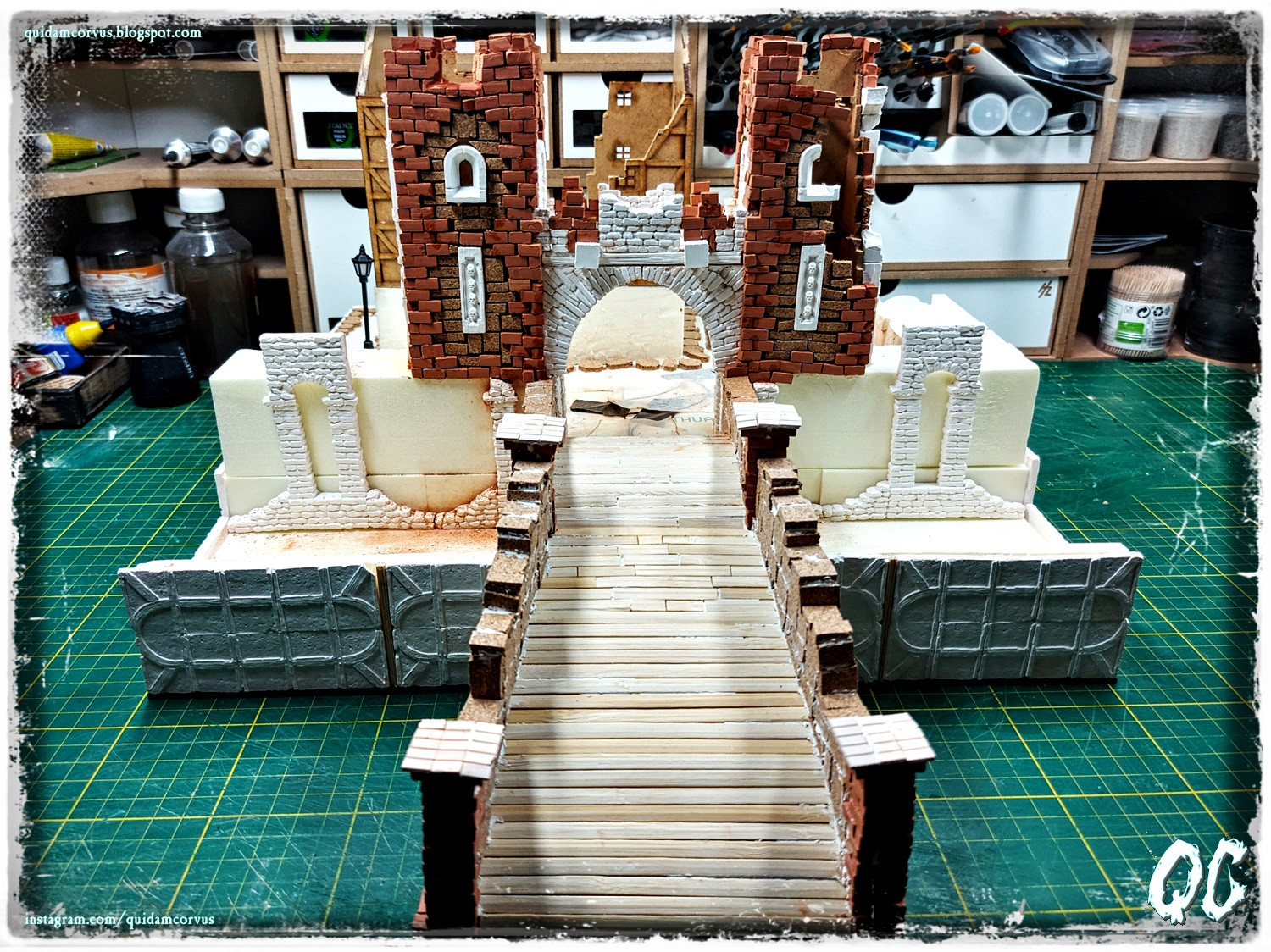

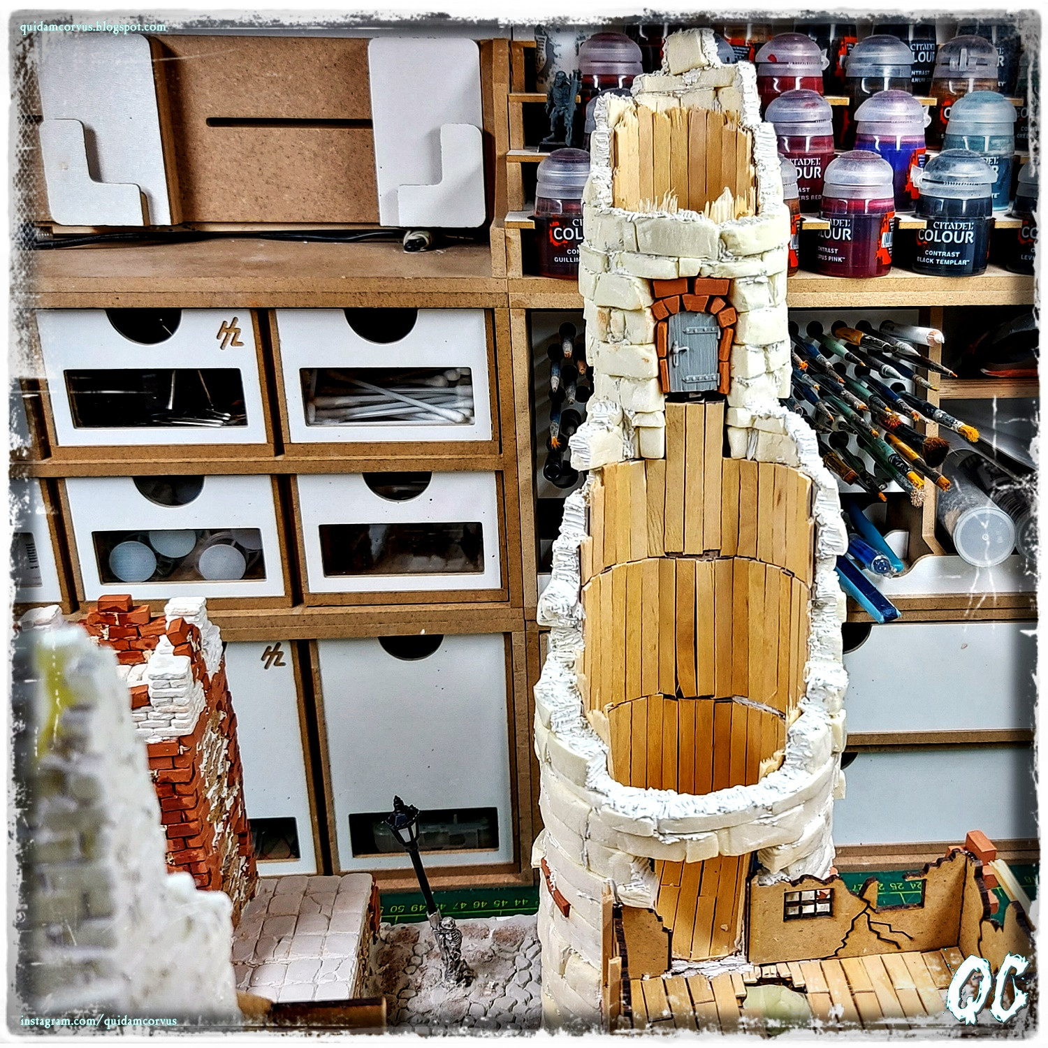

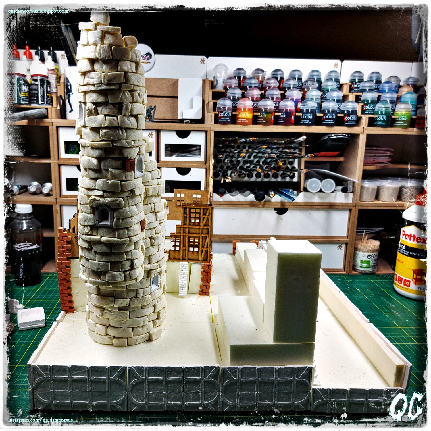

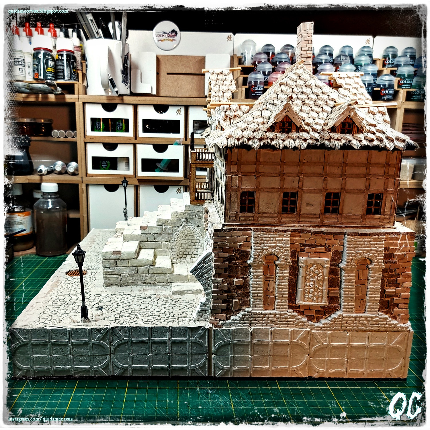

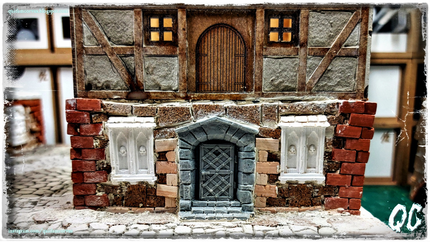

Workshop: Construction of the 'Ruins of Mordheim' modular table, part 10.

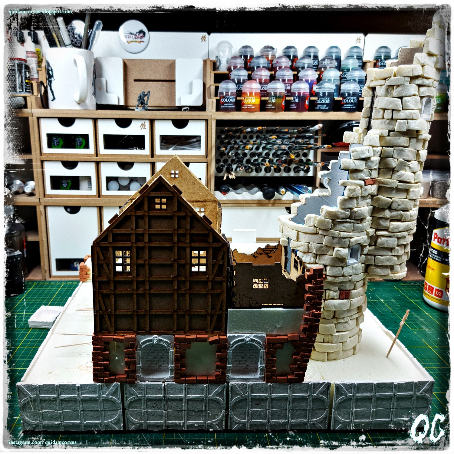

Work on the second module of the Mordheim Ruins table continues.
The next stages of work are mainly gluing gypsum and cork bricks, and then filling the space between the elements with self-hardening clay.
The half-timbered wall on the granary was made of plaster of gypsum, and the door visible in the last photo is Stone Entrances and Doors Set from SpellCrow.

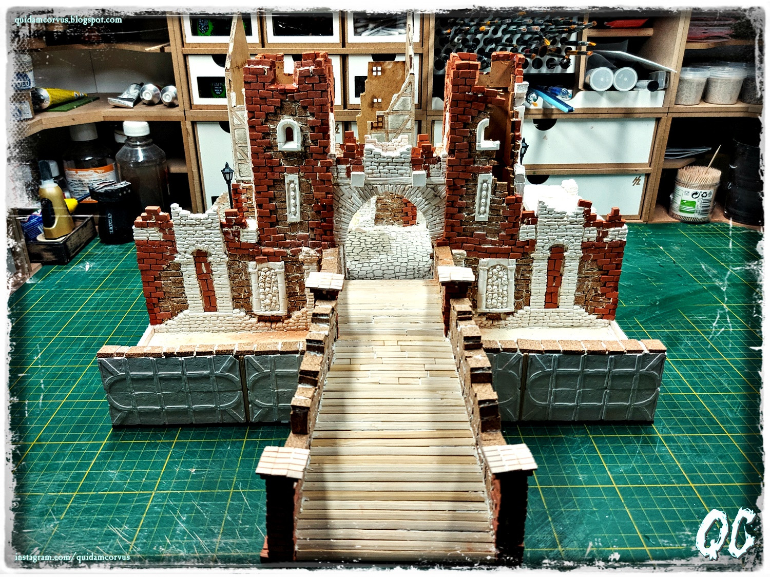

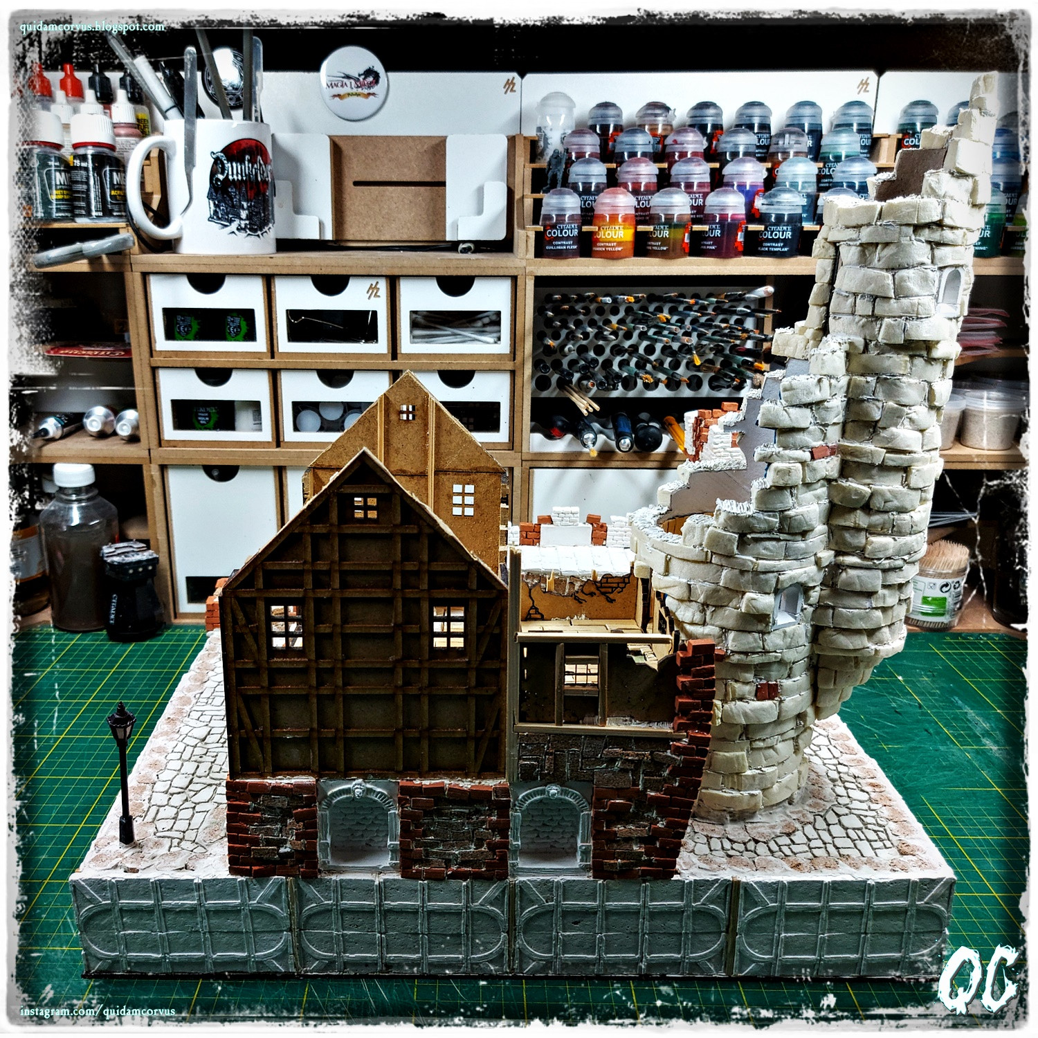

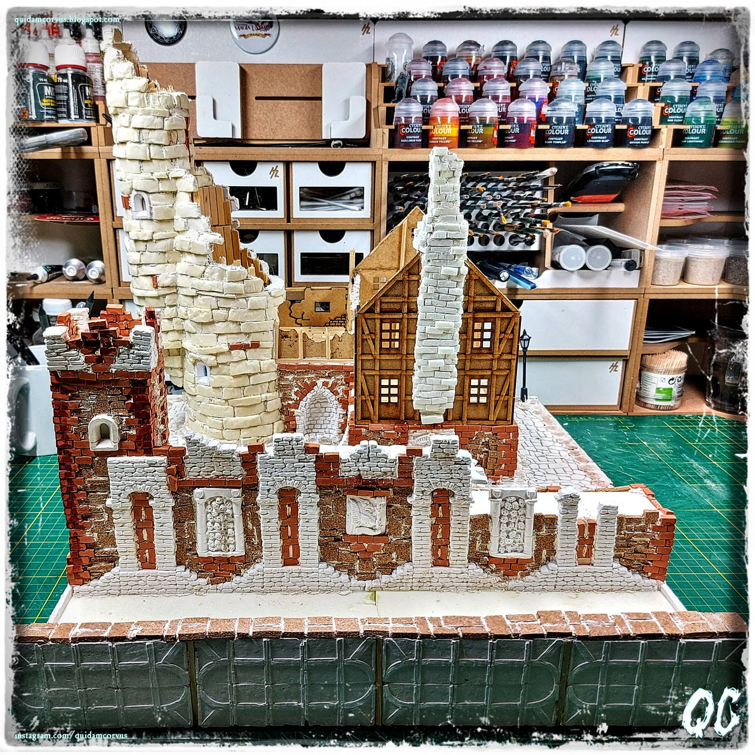

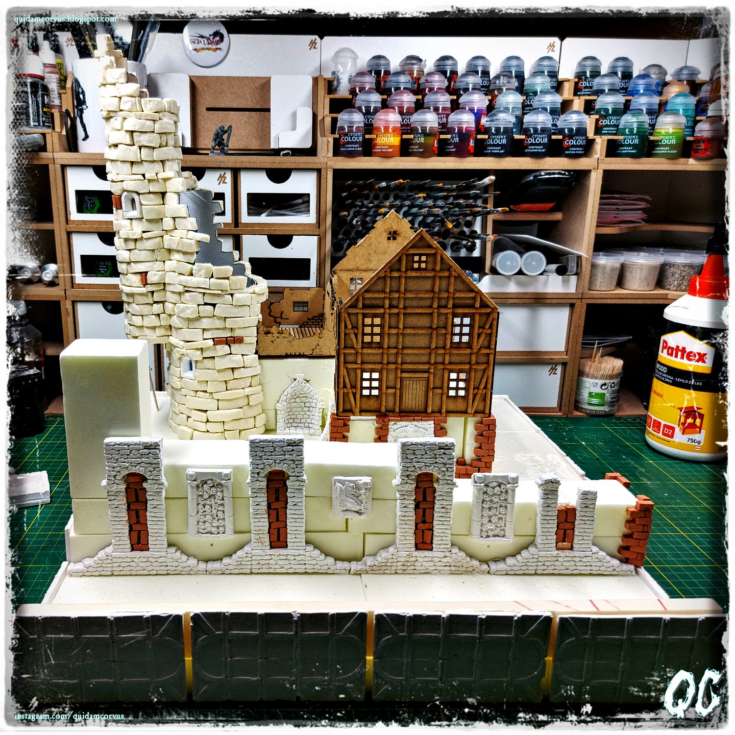

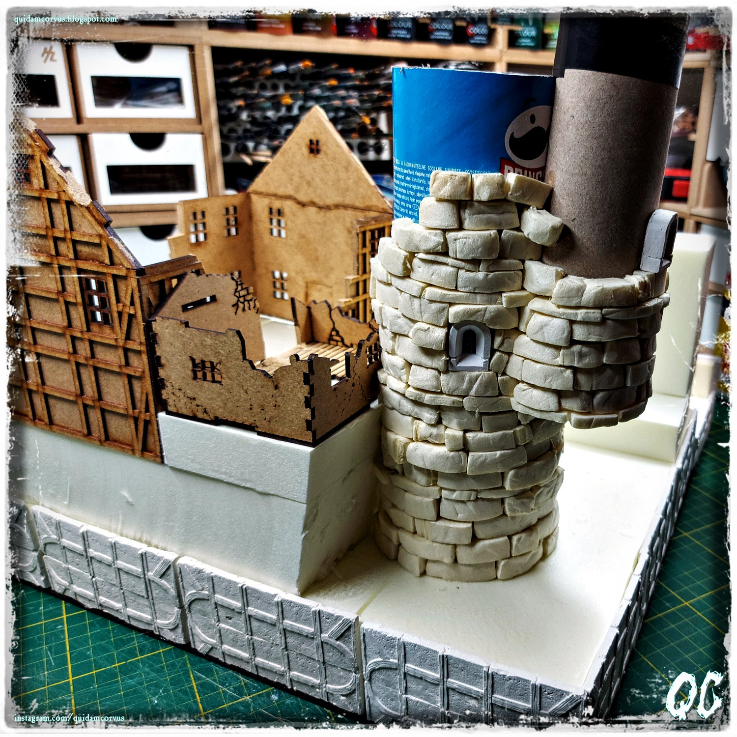

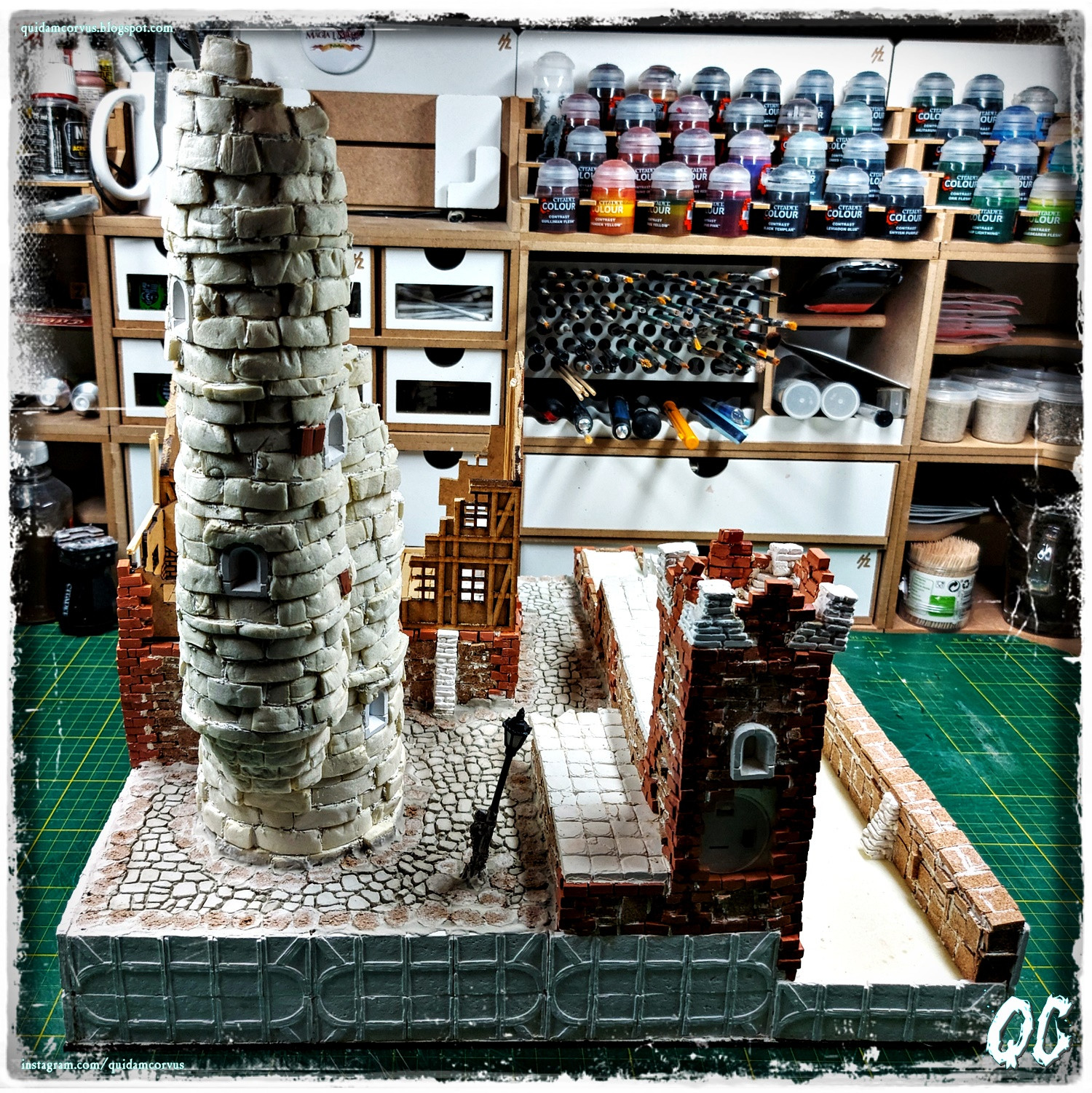

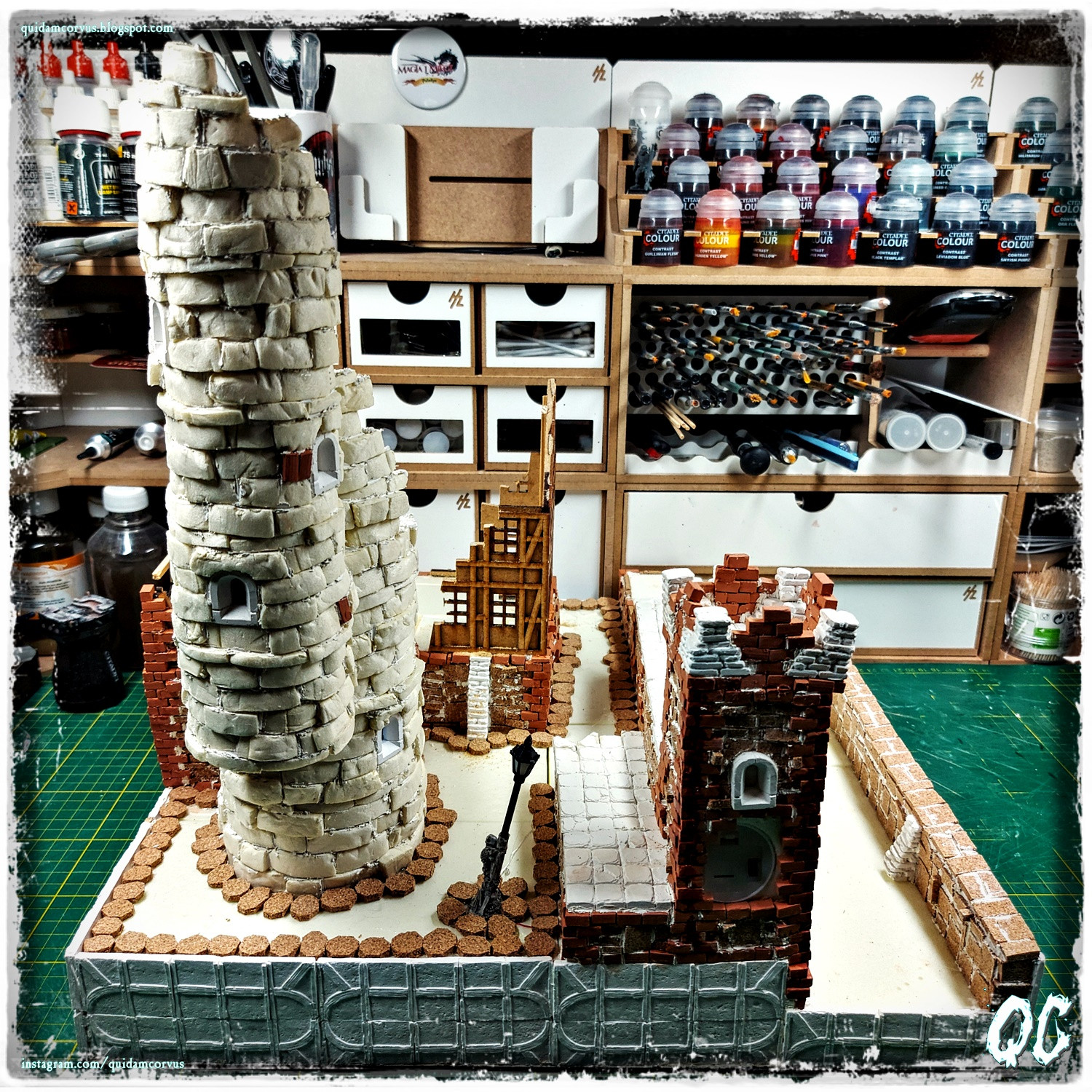

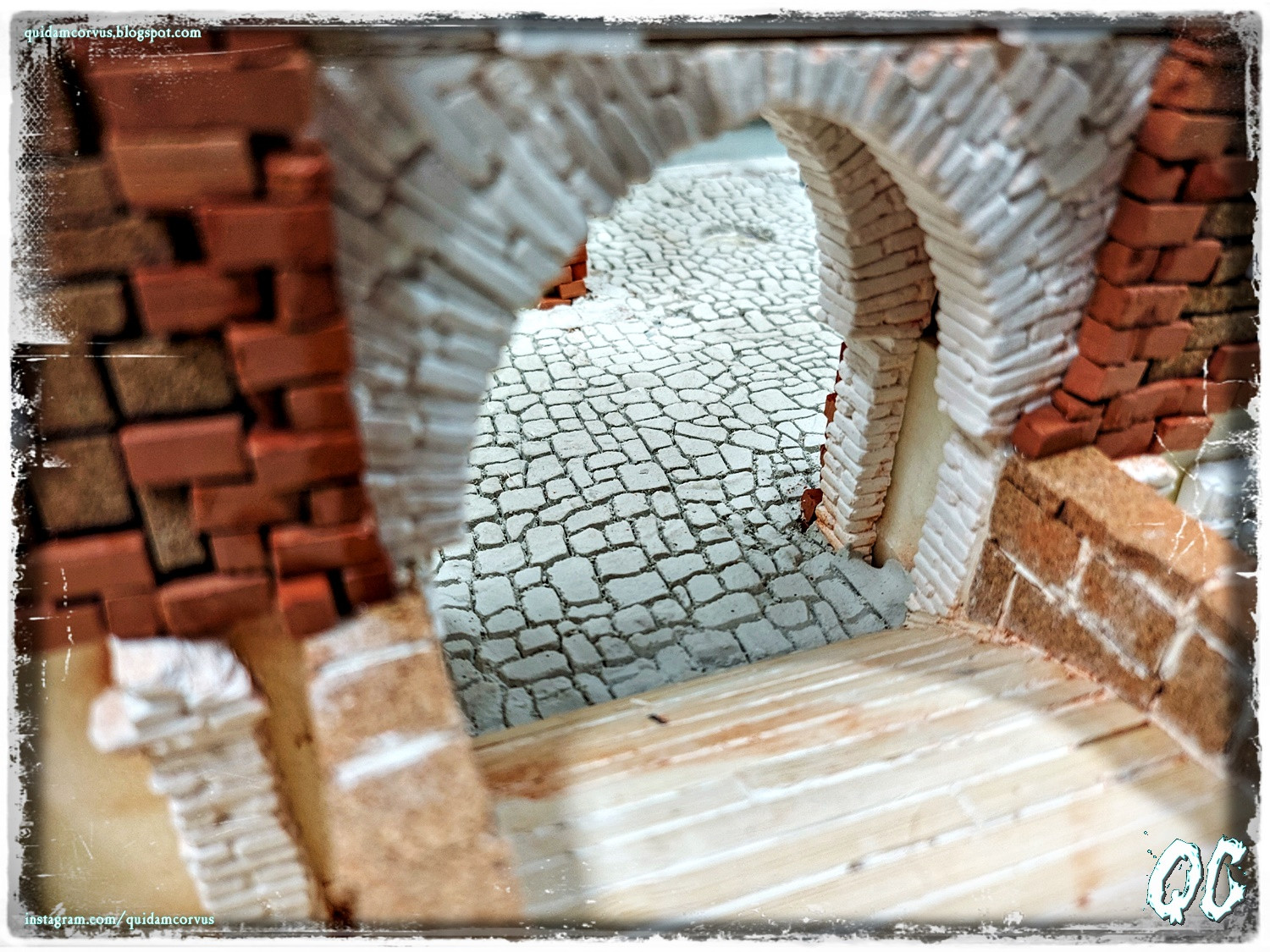

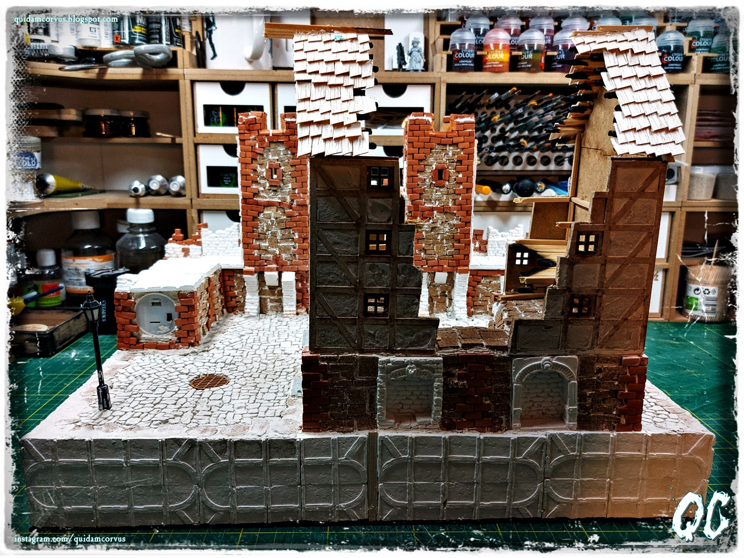

Workshop: Construction of the 'Ruins of Mordheim' modular table, part 11.
After sticking dozens of bricks and filling the gaps with self-hardening clay, as well as building the floors and the remains of the roof in the granary, I completed the first stage of work on the second module.
In the pictures below you can see what I have built so far.
Citizen Sade":3d74zgo3 said:
Epic.Are you keeping track of the man-hours that have gone into it?
Thank you.
I think one module is about 20 hours. I plan two years for the entire table, including painting.
Michael Stockin":2lpmvqhr said:
Superb, simply excellent.
I am glad you filled the gaps with plaster/mortar, it takes it from great to even better!
symphonicpoet":2lpmvqhr said:
The crazy tower is utterly fantastic! :)
Caradepato":2lpmvqhr said:
Inspiring stuff! The amount of bricks is flabbergasting.
Thank you very much. :)

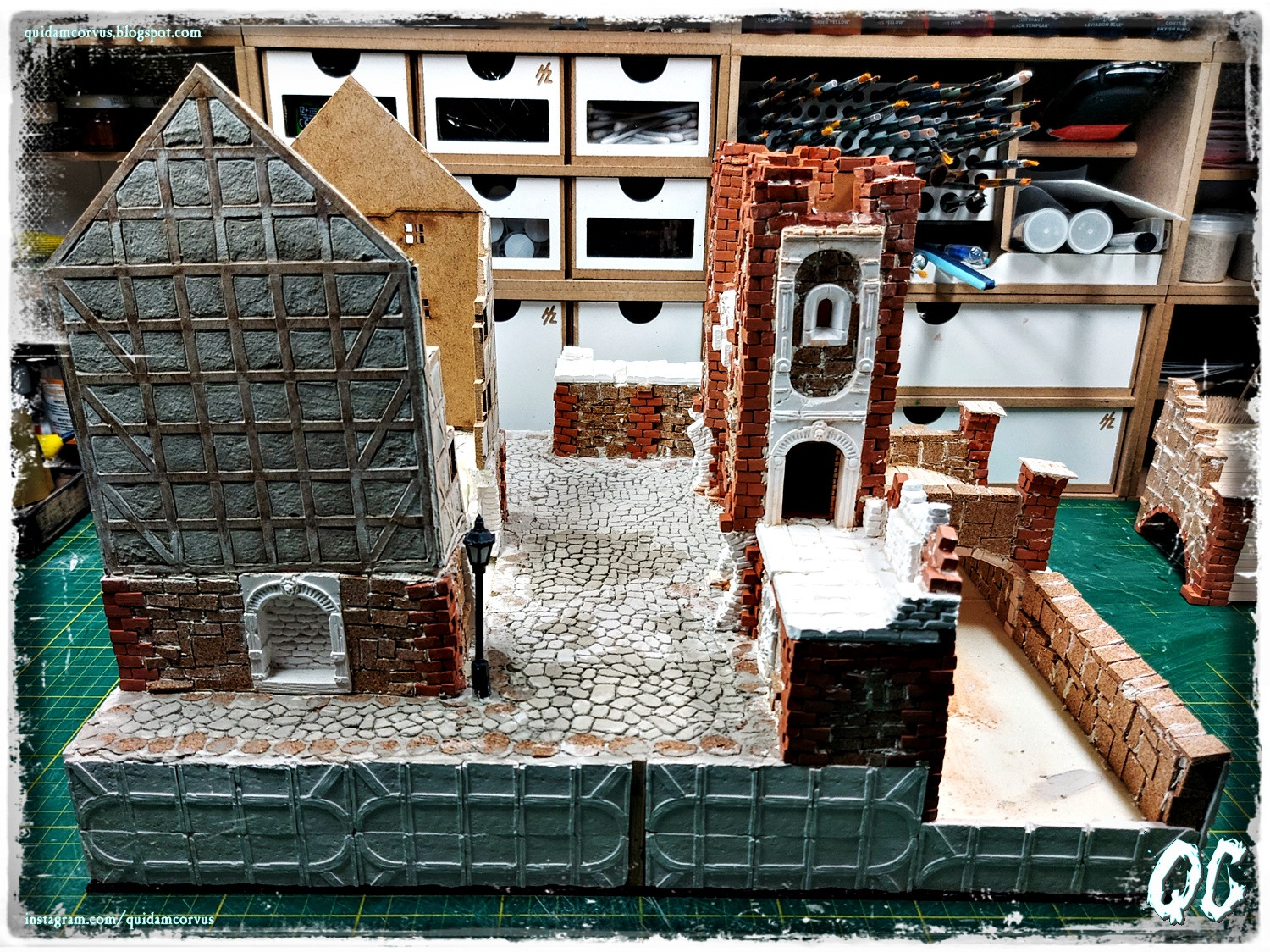

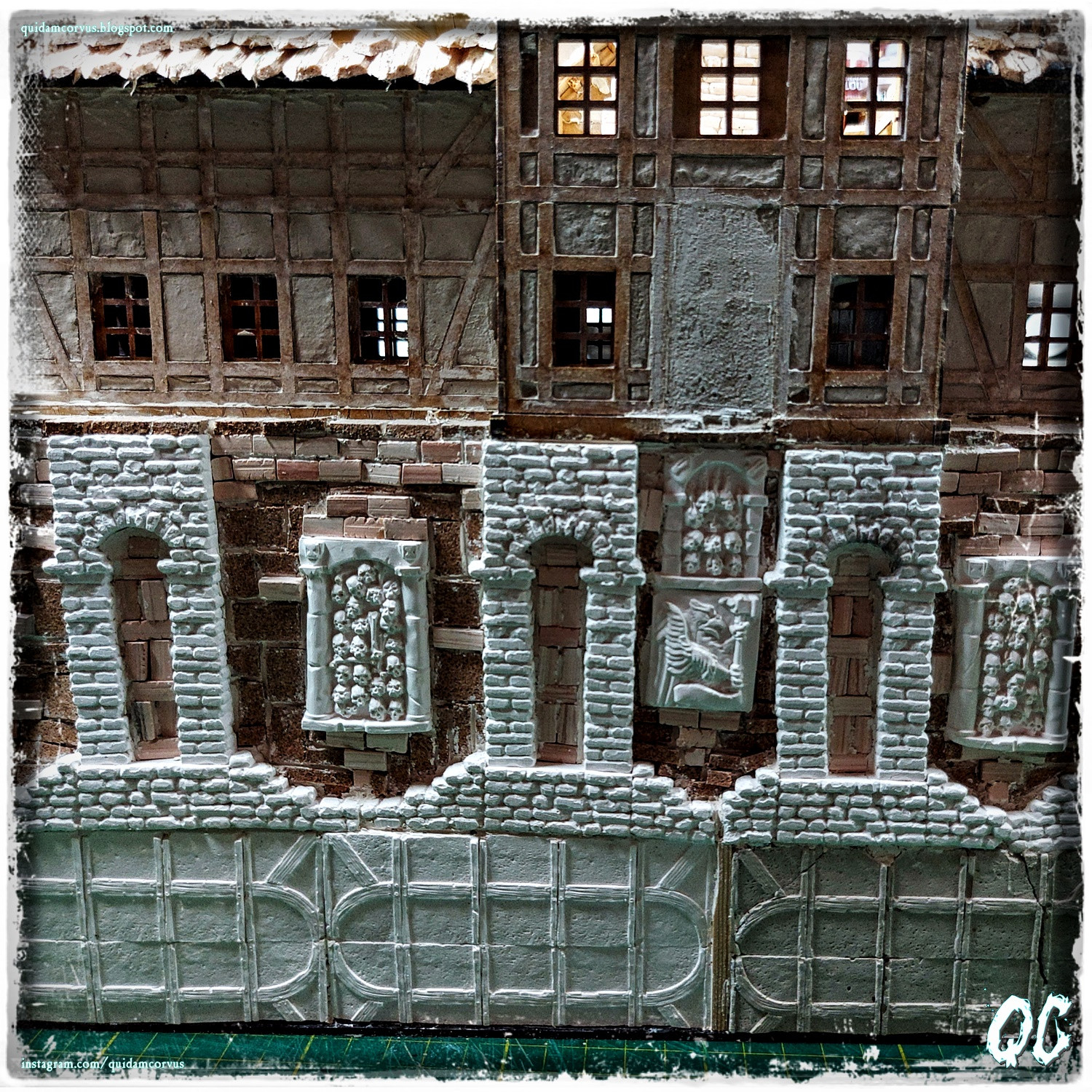

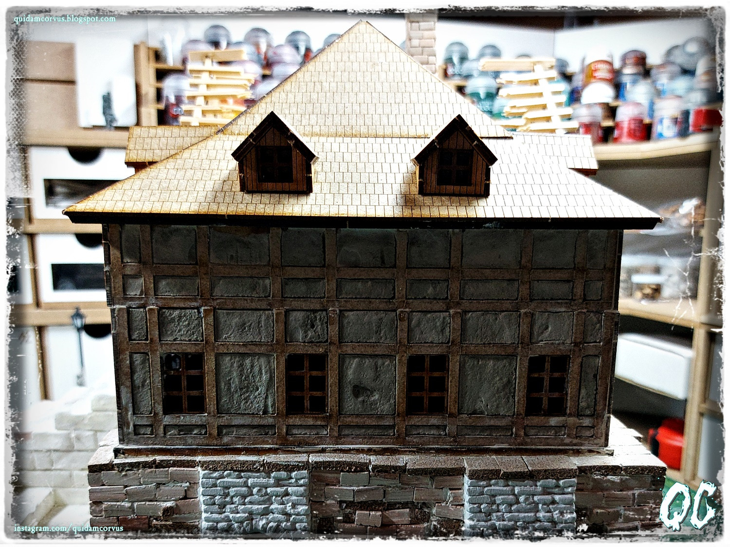

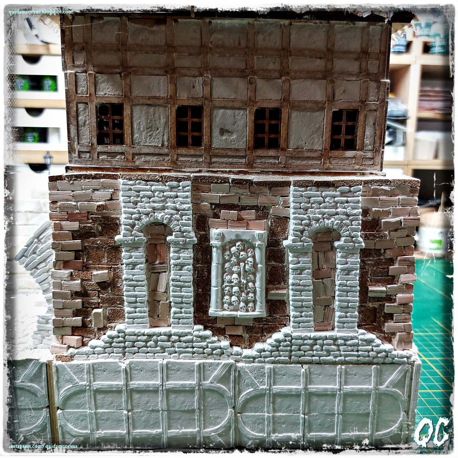

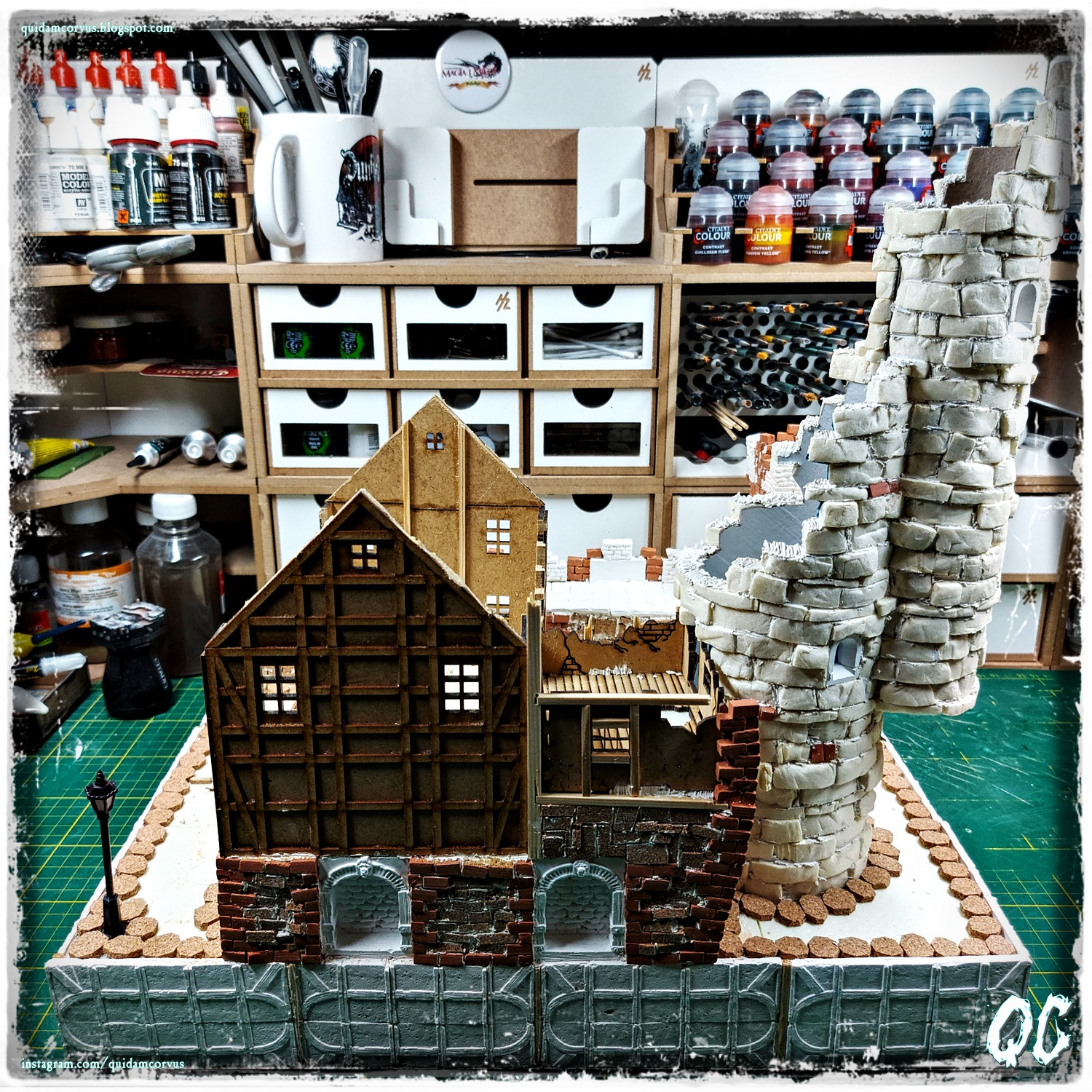

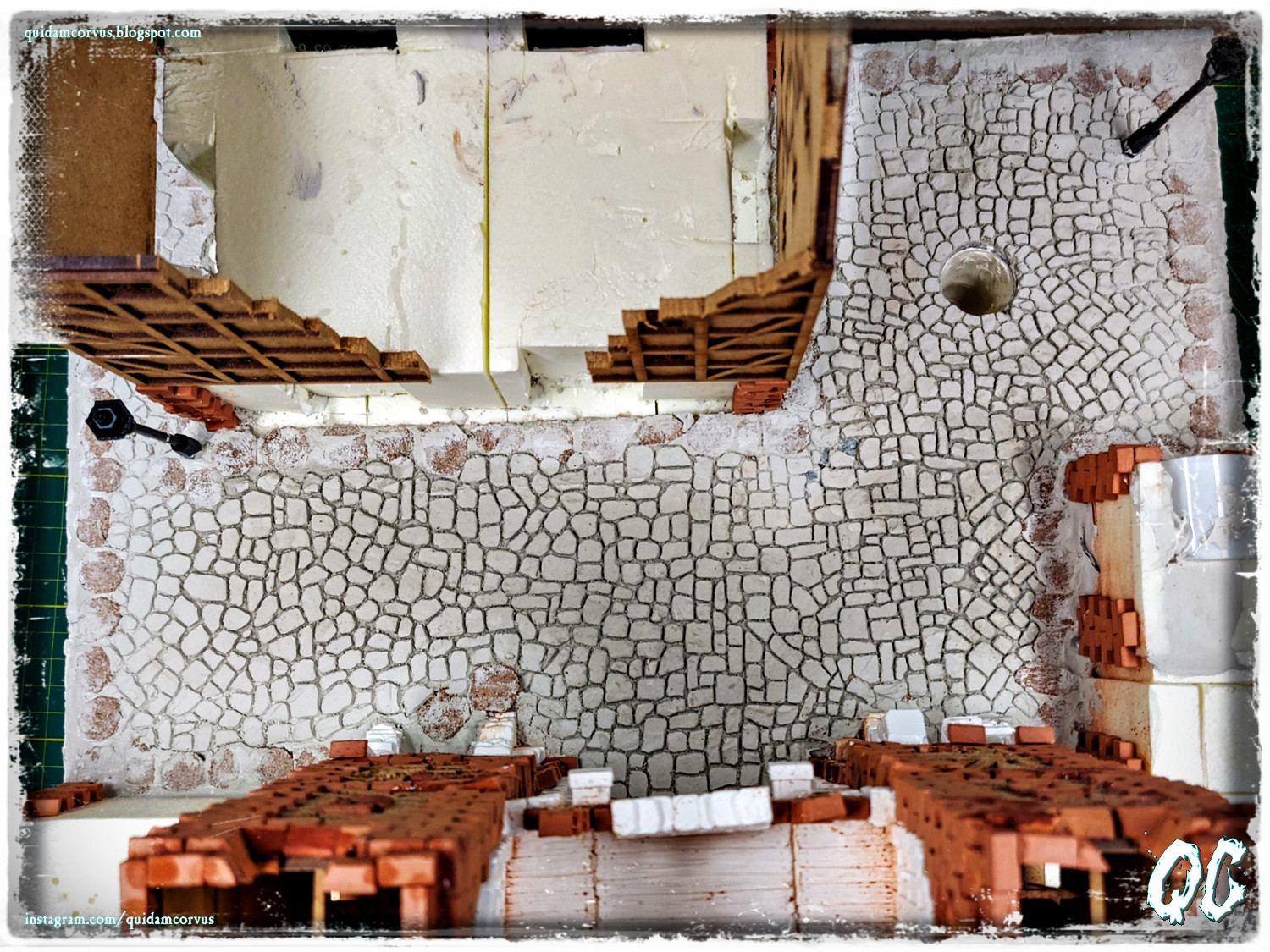

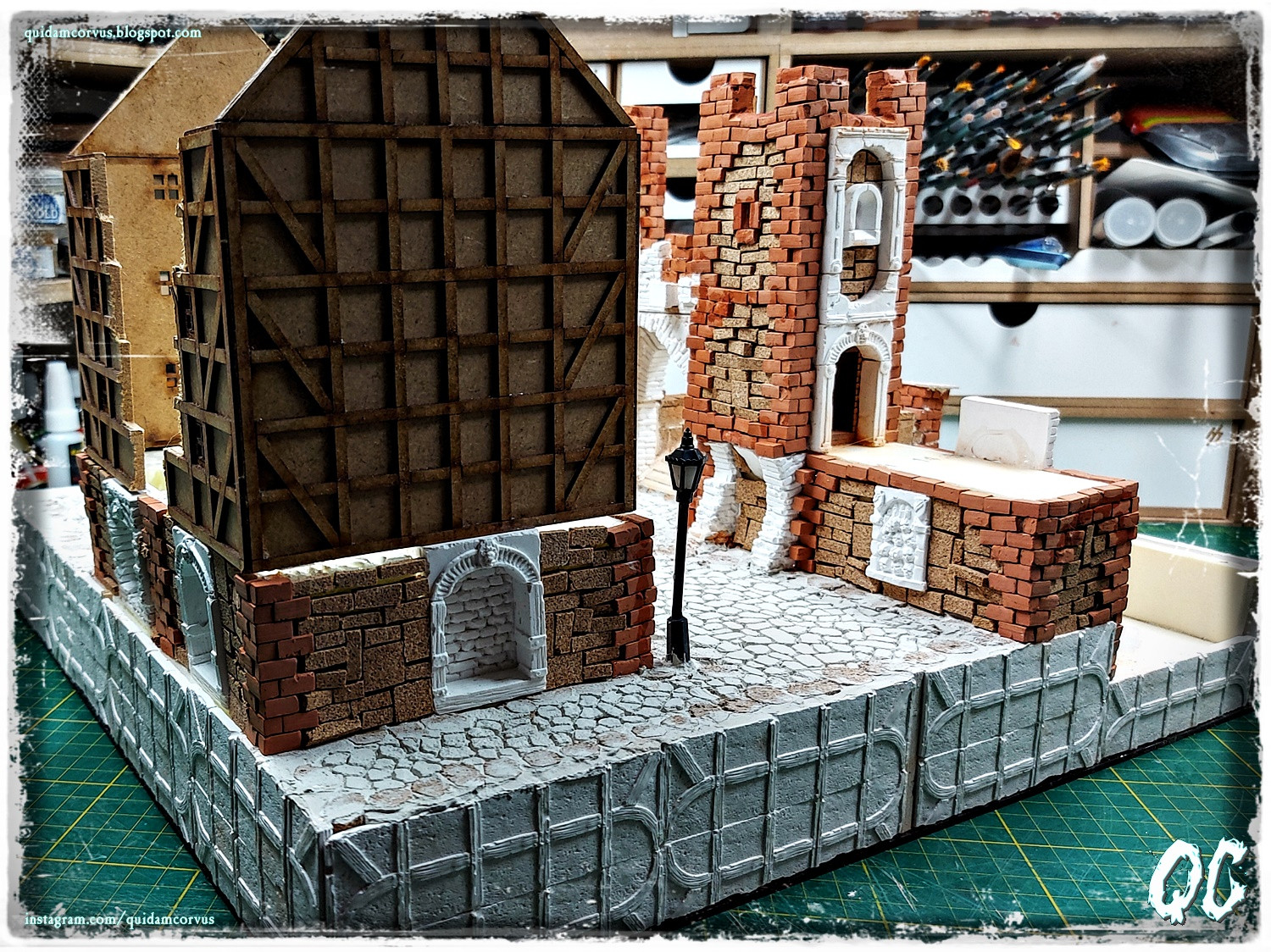

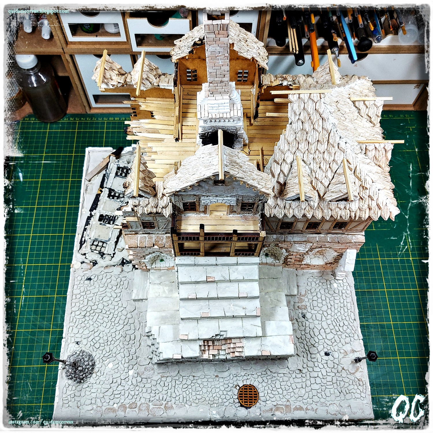

Workshop: Construction of the 'Ruins of Mordheim' modular table, part 13.
Work on the next module of the Mordheim Ruins table continues.
I covered the mock-ups with gypsum bricks, filled the gaps with self-hardening clay and gouged out the pavement in gypsum putty.
I also made a chimney out of cut styrodur, which I added to the house model.
In addition, I covered the interiors of the buildings model with wooden slats, cut into sections.
