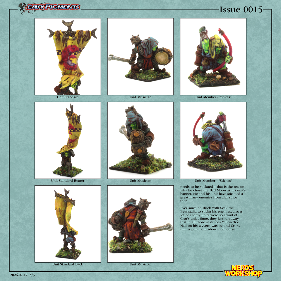

The banner I attached with one dot of superglue on each strap.
When that was dry, I cut the overly long straps short, until they just wrapped around the poles, and attached the end also with a drop of superglue.
I did the banner way too long, in order to be able to cut it to an appropriate length when on the model. If I had designed it too short, there would have been nothing I could do about that, cutting a too long banner is always possible. I tried to give it a bit of a frayed bottom
Then I wrapped the model in aluminium foil for protection.
With a lighter, I burned the banner here and there, especially the bottom edge to hide the straight cuts.
After bending the banner a bit in shape, it got a coating of thinned down Modge Podge.

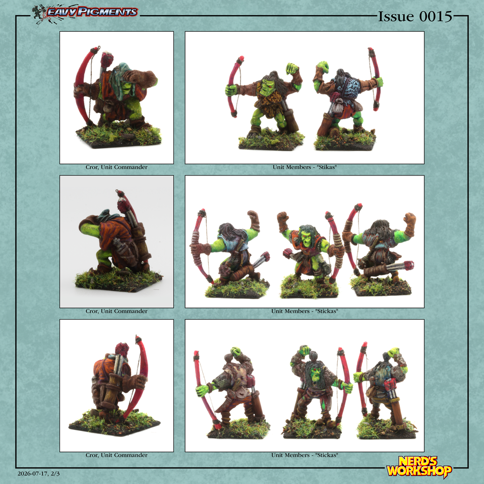

Could have been better, but at least I got this amount done :-) So, no New Year's Resolution 2026 on the hobby side for me, still busy with this one...
The second unit of Goblins took some time. I started back in Decembre with the airbrush base coat, then in March/April I got some brush work done, and it took me until July to completely finish them. I need to get up to speed with this project... But life and stuff constantly got in he way.
The banner on this unit was too integrated into the model to be easily removable, so instead of painting the banner on dried wet wipes and gluing it on, I had to free hand it on the cast banner. After painting the yellow base color with shading/highlight, I applied a coat of superglue. This preserved the work done, and would allow me to wipe away the freehand with alcohol in case I made some errors – which I might have used once or twice.

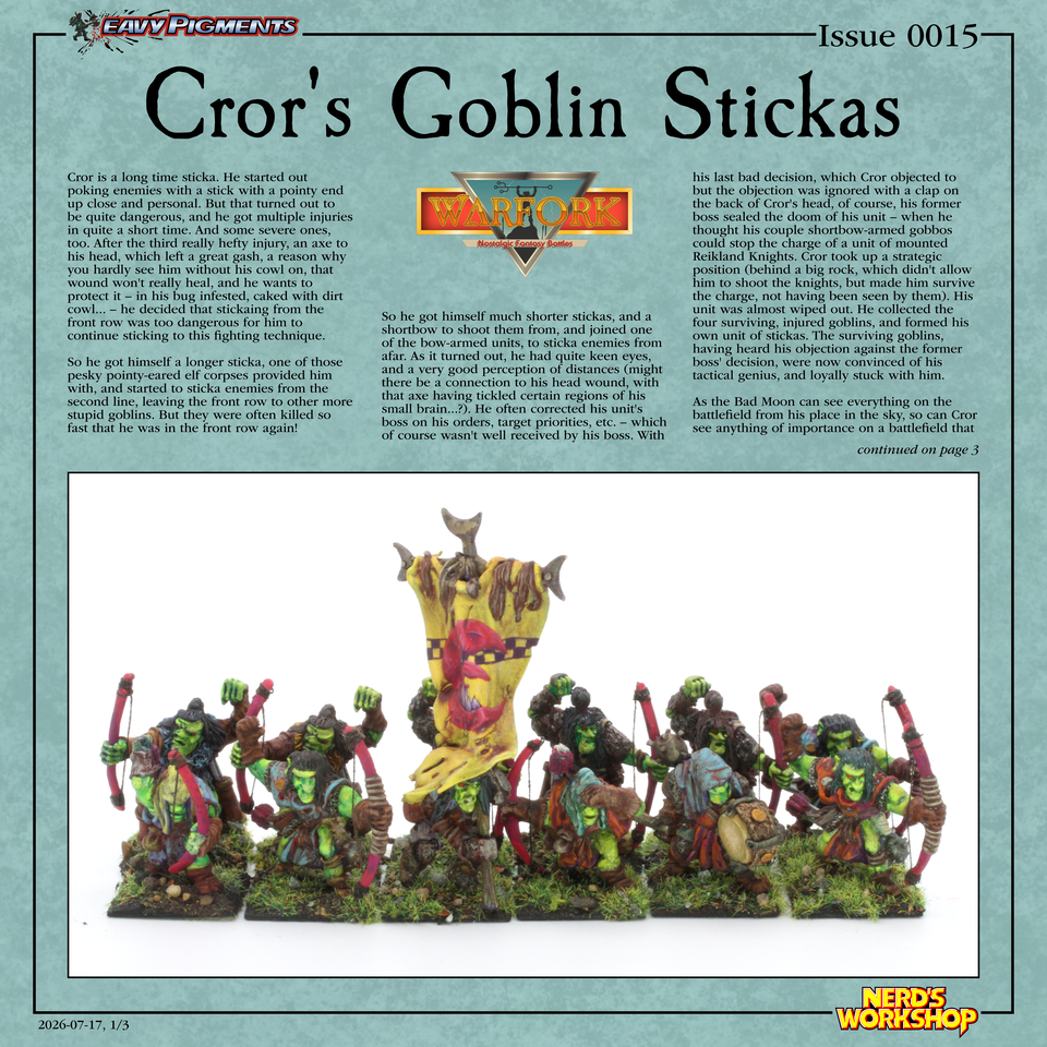

And here is the finished unit:
Great work on that unit and the presentation of the attachments. I'm always in awe of anyone who adds on bowstrings as they are such a faff -but they look fantastic!
