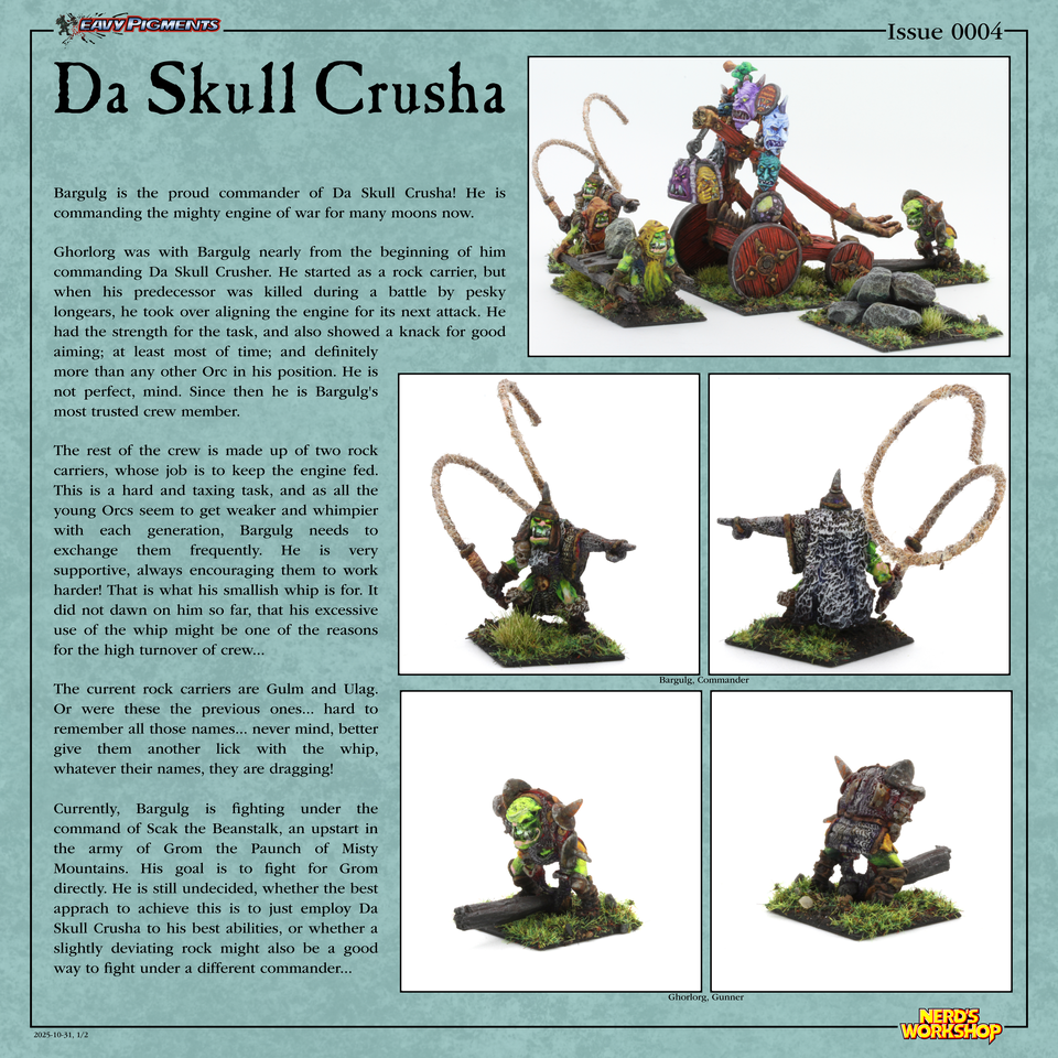

I basecoated the engine of war and its crew at the same time as the Goblin Archers. The skin of the crew got the exact same treatment as the goblins'.

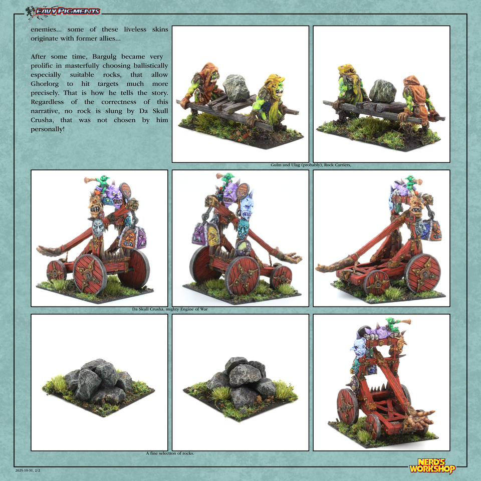

The skull crusha itself was airbrushed with Golden High Flow #532 Napthol Red Light, thinned 1:1 with Golden Airbrush Transparent Extender.
Next, with a thin brush I traced the wood grain on all side and upward facing areas with Golden SoFlat #549 Naphtol Red Light, the ropes of the mechanism with Golden SoFlat #689 Titan Buff;, and most of the metal decorations with /P3 Molten Bronze, followed by a P3 Copper Penny highlight. The iron parts were painted with Vallejo 77.711 Magnesium.
For the iron parts and to clearly distinguish the different wooden parts, I mixed an oil wash of Winsor & Newton Ivory Black and Winsor & Newton Cobalt Violet Hue - adding the violet to tie in with the basecoat. Then I enjoyed the capillary action of the oil wash.
Once this was dry, I followed with a Winsor & Newton Burnt Umber oil wash over the red and copper areas.
After another round of redefining the wood grain with red, I glued the wheels onto the engine of war and mounted it on its base. I only did this now, as for example the inside of the wheels, the chassis behind the wheels, the rope from below etc. would have been difficult to reach, otherwise. The arm and counterweight will still remain unattached for some time.
Do you know this situation, you take a look at a model a couple times, you get more familiar with it while removing flash, you think you know it - then you start painting and discover so much more you missed before. This is one of those models. The level of detail that went into the greebles on the frame is huge.
For highlighting, I used zinc white. In contrast to e.g. titanium white, it lightens the colour it is mixed into, but does not change the colour tone too much; titanium white influences the colour much more. For all the faces I wanted a dead (pun intended) look to the highlights, after all these are skins ripped from the bodies of slain enemies.

The counterweight has the face of a slain enemy nailed to each side. I used the following colors, all highlighted with zinc white again.
With all parts painted, I glued the arm and counterweight in place. Then I discovered my first gripe with the model: it is missing all the parts to make it function :-) There is no wheel or lever to get tension on the rope, and there is no attachment point for the rope on the arm. Would I have discovered that earlier, I would have added a hoop to the arm and a hook to the rope or something like that, with everything attached this was too difficult. So I just glued a rope to the underside of the arm, and pulled it taught around the rolled up rope on the winch. Still thinking of placing a rod, that could be used for actioning the winch beside the engine... not sure yet.
Except for some final washes, the engine of war is done. On to the crew.
With the crew, I started painting the ammunition. Over the white over purple zenithal, I applied 4 washes to get some variation in color.
Once these were dry, I applied a thinned down wash of black ink.
Finally, I applied a drybrush of a very pale green.
These rocks make me quite proud, I didn't use a single grey in painting them :-) There are no (purely) grey rocks in nature :-)
For the crew, I used a technique the first time, I learnt of from Ninjon. He developed this technique over some time now and it features in many of his recent videos. The idea is, you paint an area in a colour transition of two colours, wetblending these where they meet. Then you paint your main colour of that area over this basecoat, letting it show through, and you quickly get a complex mix of colours without long blendind times. I decided to use this technique for all the greenskins in this project.
In the following three pictures, on the left you see the basecoated models, with the two colour blends, on the right the result after applying one colour on top. The metallics I stippled on, to let the basecoat shine through. The other areas I painted thin paint over the basecoat in two to three steps, in some areas with an additional second highlight step by adding zinc white.
Overall, I can still improve on this technique, but I like the effect a lot, and it is indeed a rather quick method.
I still have to apply oil washes, but so far, the majority of painting is done.
