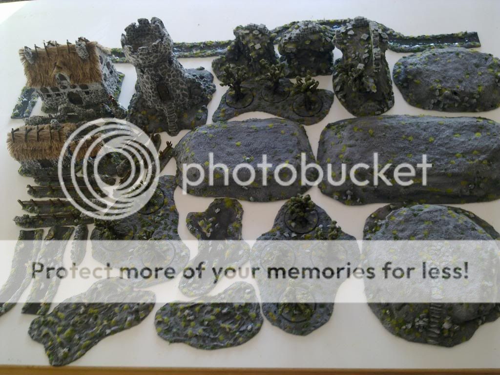

Here’s a picture of the whole set:
The whole set is 22 pieces. Basic stuff is 3 hills, 3 woods, 3 obstacles (fences), 3 buildings, 2 swamps, a pond, and a stream. In addition there are special pieces: 3 impassable rock formations that can be used as ruins, a well, a hill tomb and a statue pedestal. I constructed the terrain with the idea that it should a) be playable and b) not be too high standard (I wanted to complete the project in reasonable time). I also tried to use the materials I already had as much as possible... and no foam :)

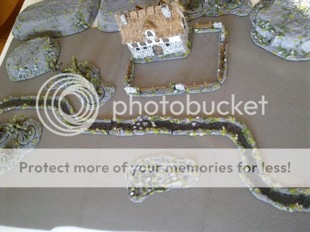

Landscape:
Landscape from the other side:
I don’t have a board and thus I used a piece of old tent mattress to simulate grey ground. Might look a little better than white background.

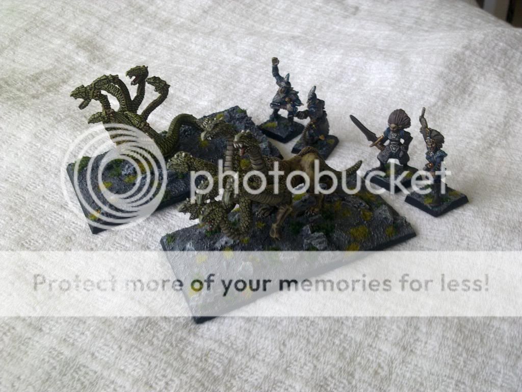

In last month there was an uncomped tournament and I acquired a second hydra for that (the one on the front):
After the tournament I came into conclusion that I’ll expand the army a bit. I acquired a second unit of Harpies, a second unit of Shades, some Crossbowmen and some Witch elves. More about these later...

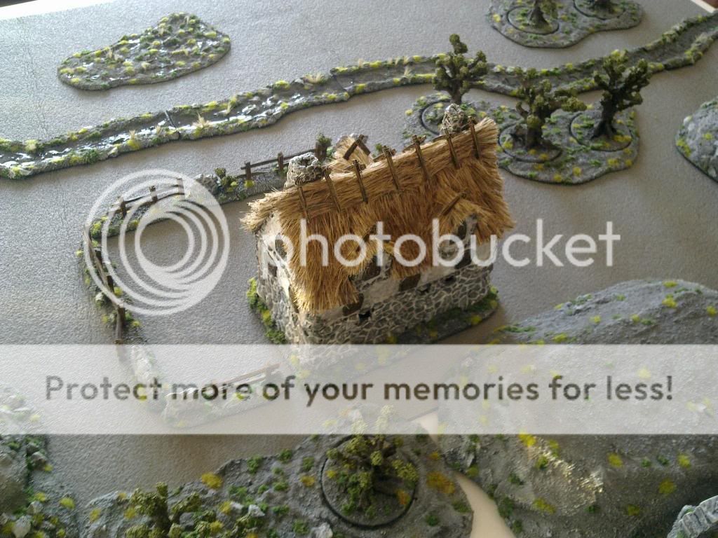

That all looks great! I particularly like the thatching on the roof of the house.

Thanks for the compliment, you trusty commenter ;) I also like the "thatch", which is made of lumps of cheap horsehair brushes and toned with "Soft tone" ink.

Perfect is a pretty strong word, but thanks :) I chose grey 'cause it's the colour of my army's bases. I also thought that there's enough "standard" terrain in the world already - this is like a desert table, but grey. It's a bit unnatural, though (in the real world salty soil might look grey... but this is fantasy :P). I suspect the colour is a bit of hit and miss.

Well, I admit perfect is quite a strong word, it would need boobs, a railgun and chaos mutations to be perfect... However, it's really good looking, well designed and very different from the usual stuff
I'll think about a tutorial if there's reasonable demand. I'm not sure if the techniques I used are that special. It's also quite time-consuming to write one.
A grey table doesn't look that unnatural to me. You can find near shore landscapes of limestone or sandstone with very close colours, I believ it would only take a little more vegetation to make it look natural.

Thanks for the more elaborate analysis of your opinion, Asslessman :) Do you think I should consider more vegetation here? Any ideas? Also, thanks to Mr. Saturday for the comment.
My intention was not to be iffy about the tutorial – I’m happy to share info about the building process of the buildings.
The watchtower was built from small rocks which I attached with milliput around a styrox cone. After that I “washed” the whole structure with Fimo Air modeling putty. This filled the gaps between rocks, covered some depressed areas and gave some form to the structure.
With the houses the process was a little different: I cut the four wall shapes out of cardboard and then glued the stones of the edges, lower windows, and doorways. After that I just poured glue and then stones to the empty area I wanted to be “stone” (the whole small building and the lower floor of the bigger one). Then I applied the Fimo (upper floor of the bigger building are just Fimo). Voilá!
Well… almost. I glued the slightly twisted (due Fimo and glue drying) cardboard pieces to the base and then some stones to the corners of the buildings. After that… Fimo :P The Well, the chimneys and fences were just stones glued on top of each other and covered with F... you get the idea.
I built the roofs from wooden strips, glued the chimneys and finally added structures on the roof, doors, and windows. The door was milliput and the windows old Citadel shields + milliput. Then I turned into straw… thatch man. Margaret That!

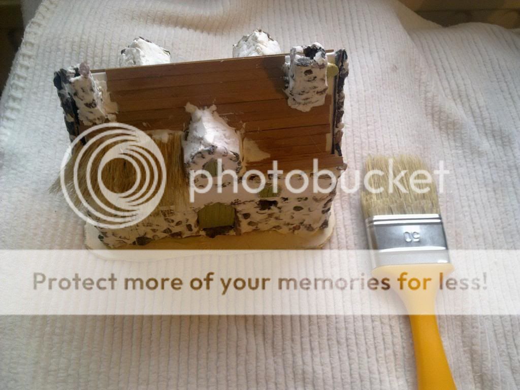

I found a picture I took during thatching:
The picture illustrates the construction of the walls a bit too. Thatch was made of brush hair. I cut it into lumps which I attached to the roof base with PVA. This took time and would have looked even better if I had more time and experience. Then I added the support wood structures (obechi + thin wire).
Edit: I cut the "thatch" a bit with scissors after it was dry. If I'd used shorter hair the result could have been more realistic.
After thatching I painted the thatch: a coat of matt varnish followed by Soft Tone (army painter – it’s basically a brown ink). I considered adding a second coat of colour (Dark Tone) to simulate dark thatch but dropped the idea. Then on to walls… first a basecoat of grey, then a dark grey wash. After that I painted the lines between rocks (what’s the name of the stuff they use in masonry, I don’t recall the English word now?) with white to simulate stone pattern. That was slow.
The shapes of the masonry came partly from the rocks but I just made some of it up. The uneven surface of the Fimo helped to make the end result look ok.
Edit: I think I highlighted the building with white at this stage. I also made door handles and metal parts from paper. Rivets were made of acrylic putty (dotted with a cocktail stick).
Then I painted the doors and windows (light yellow followed by sepia ink for the wood, rims with metal), added and painted some shields (decorative) and finally I hit everything with thinned Dark Tone Ink. Well… there was a coat of matt varnish after that.

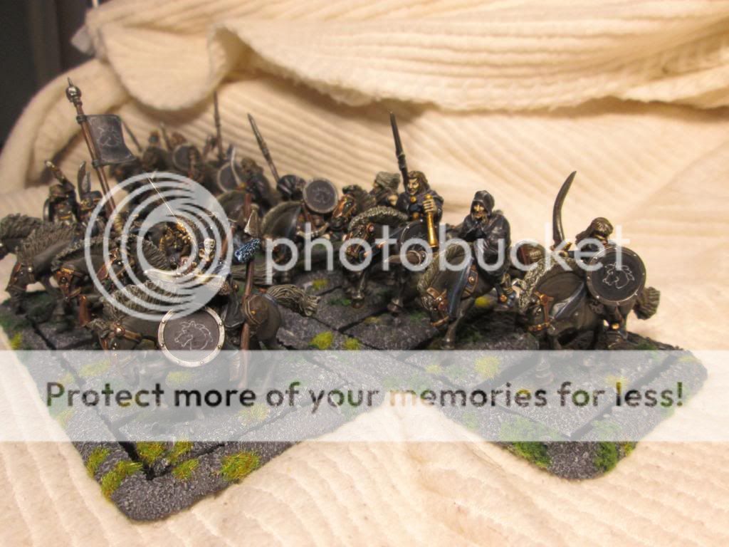

So I started with some updating. Dark Riders shields:
I just did the shields by painting a simple horse head on each of them. The head is similar to the one on their standard. Quite frustrating as some of the original models had shield boss which I removed abou a year ago… and now it would have been useful :P

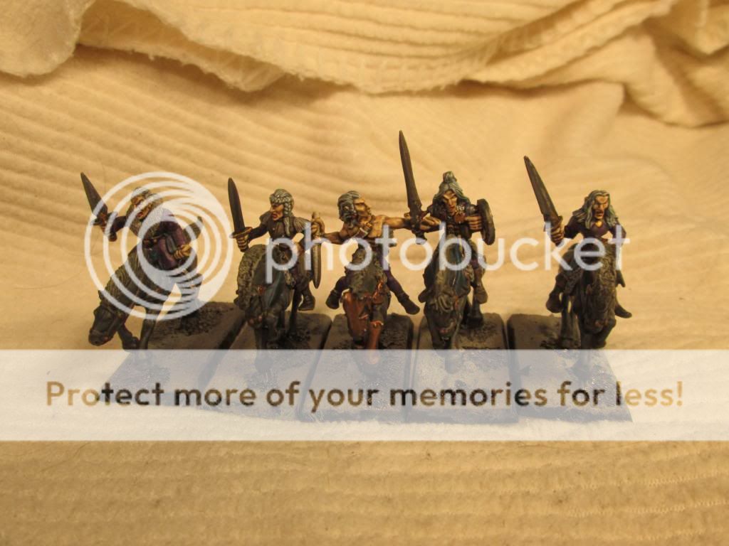

Warlocks WIP:
These are wood elf models on old metal horses. There would have been more bare-chested elf figures, but I decided to go with these as I got them for a relatively cheap price from ebay. Not the most beautiful stuff, but will do. These are just painted with basic colous, dipped and varnished (matt).
