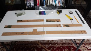

Whilst I wait and take advantage of my wife and daughter being away the weekend (though the Mo In Law is still here), I am making some nw roads.
I have 2 main goals, the first being to make a road that can be used with the river:
And a road that spans the width of the table in as few pieces as possible, turns out that is 2 sections, plus I have some left over.
I have also made these the same width as my existing roads, but as I no longer have the paint used for the original roads I am not sure how well they will match up.

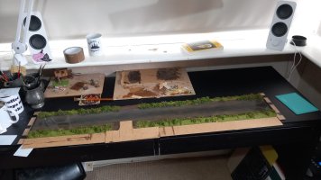

I have repainted the roads, vanished them and flocked the edges.
The river is god awful and were it not for the money spent on the tufts/banks I would bin it and start over.
8: But, I have repainted the whole river, thus making the 1.5 bottles worth of liquid water invisible and pointless.
I still have these crest/waves/currents and short of starting again there is not much I can do so I have tried to highlight them a bit and make them sort of choppy current.
It is currently a very mat flat river.
The effect it has at the moment could be achieved by some thinly spread Polyfilla.
The plan is to add a couple of coats of gloss varnish and hope that does the trick.
