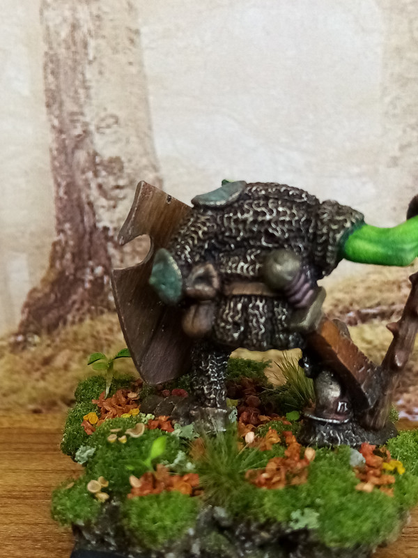

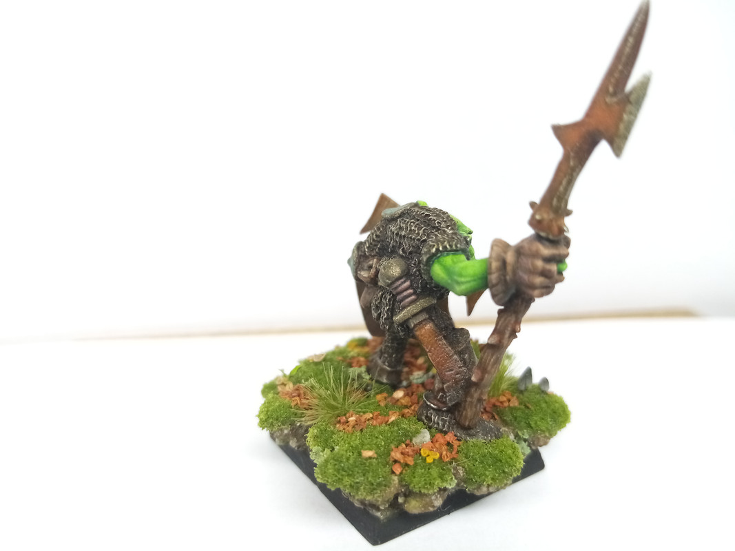

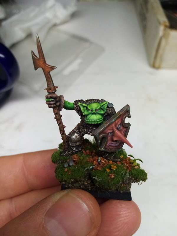

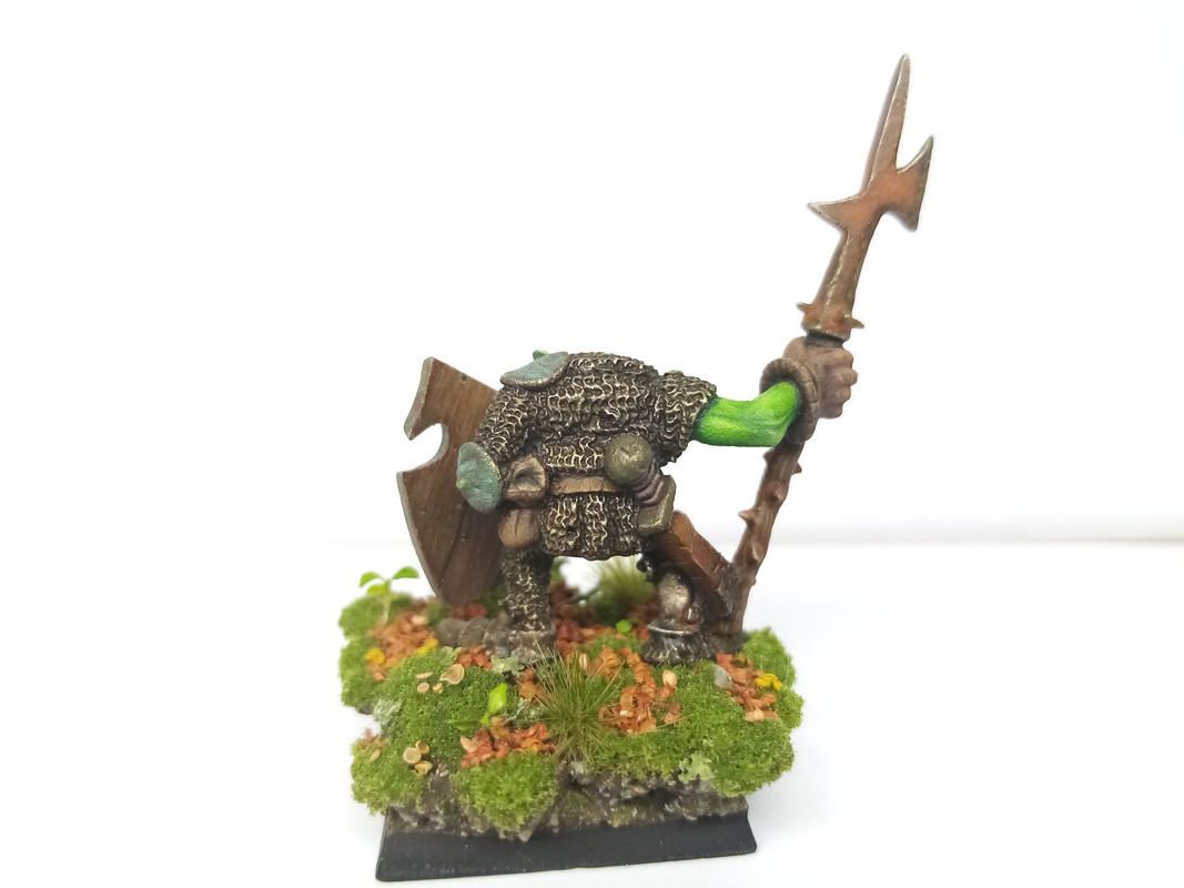

Making the base took longer than expected and led me to ditch 3 or 4 ot the things in the process, basically because I took the opportunity to experiment the best ways (to me) to make moss, soil and leaves. As per my habit, I tried to use as many natural elements as I could: leaves, fungi, the fallen branch between the orc's legs, lichens and little plants all come from the backgarden of my granny's countryhouse and the woods around it (obviously most of them required some sort of treatment and/or some licks of paint, but I think they have an inherent delicacy and come in such an appropriate size that artificial products cannot quite replicate their effectiveness).

No, I stopped using it as i find it a bit too large for 28mm minis; it's fir seed (or rather I think it's seed: as with birch, it comes in little cones falling from fir trees: once crushed, you get lots of crumpled micro-leaves which can be used as are or dyed; in this case I dyed them 3 tones of orange (brownish, reddish and yellowish) to resemble beech leaves, as I'm planning a beech forest theme for my next bases).

On the very last one with the pine seed husk leaves, is that clumps of real moss on the base that makes up the bulk of ground cover?

It's actually fine turf mixed to matt clear varnish and applied randomnly to create moss clumps; I then applied a very thinned down brown (oil) wash along the edges to simulate the root part of the moss.
On some test bases I made earlier I tried other recipes for the above mix (added light green pigment and/or yellow oil wash when dry), but somehow the didn' t look as convincing (or just too different from the moss I observed in real life).

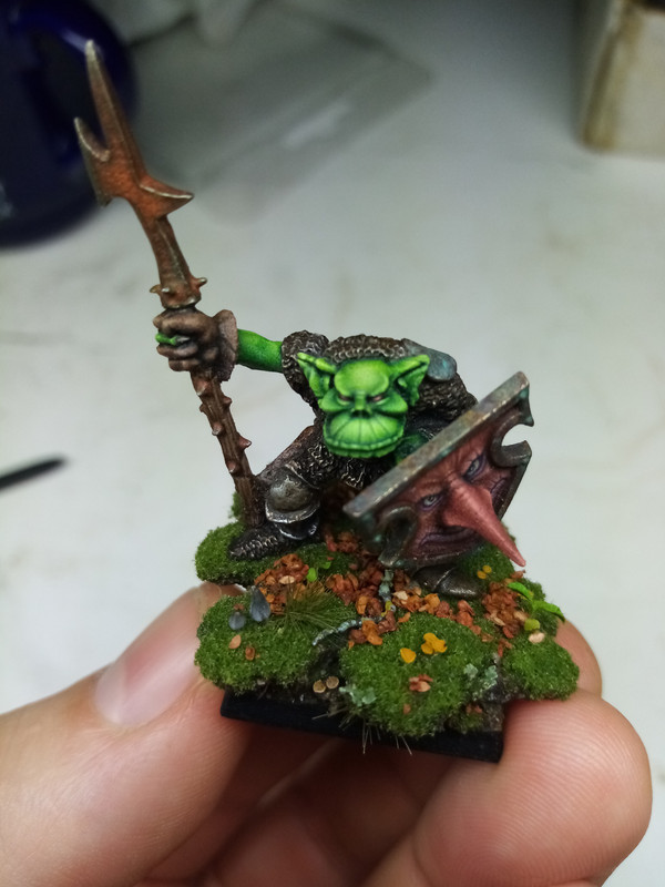

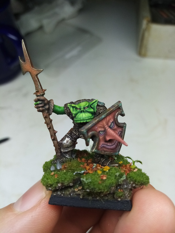

Outstanding Orc! Fantastic skin tone transitions. The rust effect on the weapon, the shield front and back are extravaganza!
May you like to share your green skin recipe with us? I have a bunch of Orcs laying around and I am not sure about the right colours to use.

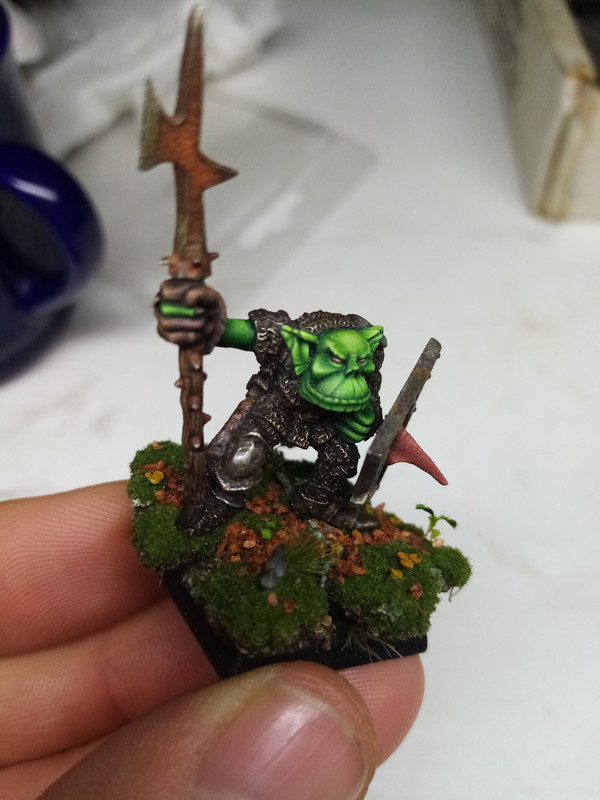

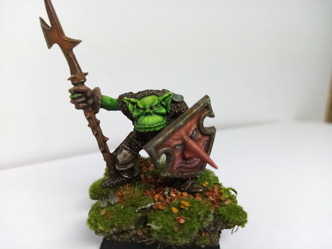

My skin recipe is quite simple and straightforward, but a little time consuming:
- as I've always used Citadel paints, I try to stick with them, even if some of them are showing signs of deterioration: on the last orc I combined them with Scale75 greens, but they didn't impress me much, as they tend to change quite a lot in appearance from wet to dry;
- I start from a dark base tone (thraka green or the likes), add a smooth layer of goblin green, then start to glaze some sort of bilious green (years ago I made my own mix of striking scorpion green+skull white+sunburst yellow - I've got some original bilious green pots, but my mix has stronger pigment and covers more) and finish adding some more white to the bilious mix.

Acrylics do tend to get darker after they dried but then again it might be that pigment load isn't that good so no matter how many times you paint it over and over again, colour underneath will always show through.
Did you try to mix green with something like screaming skull paint or zandri dust? Not all colours are mixed with white or yellow alone. I usually mix them ( green, red, blue and especially black ( with zandri or similar for highlighted black ) with screaming skull, zandri dust or bubonic brown. After I add yellow in it for highlights or white for that matter, depends from where coulor came from ( closer to white or yellow ).
I've only recently encountered some trouble, as my "bilious" mix is probably starting to dry up and I find it a bit...rough.
I purchased Scale75 paints for the promised matt finish, but in the end - for skin or other parts requiring a subtle finish - I largely prefer citadels, as they're easier to manage when glazed on: they have a translucent finish which actually helps in making darker layers showing through, giving the painted part a realistic depth of colour.

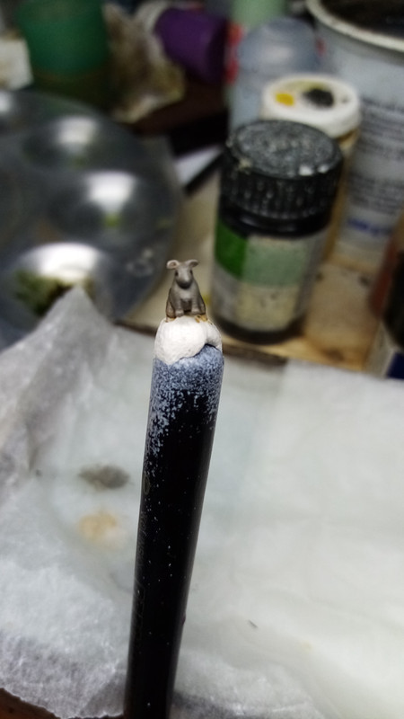

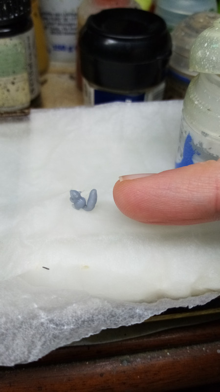

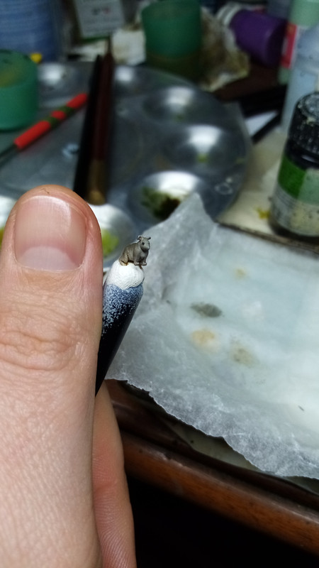

- first of all, I'm working on a more elaborate naturalistic base for my Tuerto from a few pages back: as it's an unreleased mini (and a gorgeous one to me) I've always wanted to place him on something a bit "important"; unfortunately I had to ditch the tree base I showed in this thread (i went a step too far in adding colour to the moss, ruining it) and I had to build something else: I've already done the bulk of it and I'm currently painting the finishing elements (mushrooms&fungi, animals, plants)...it should not take much longer: here's a finished rabbit, next in line is the squirrel (both from Serious-play on ebay, in 28mm scale):
