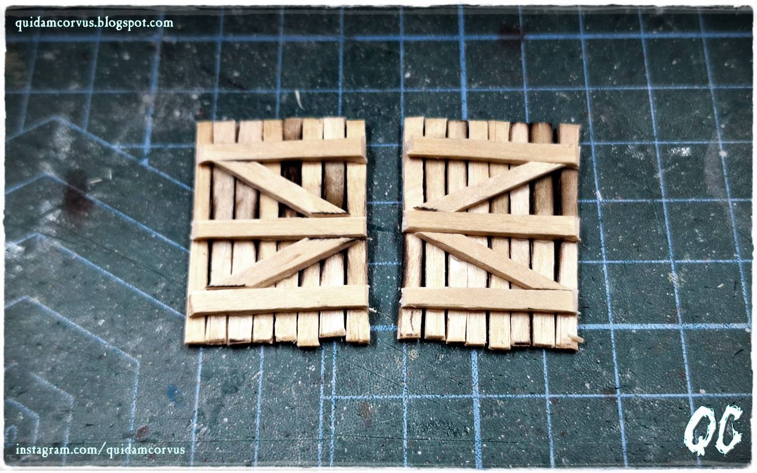

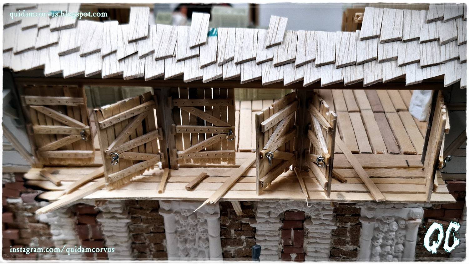

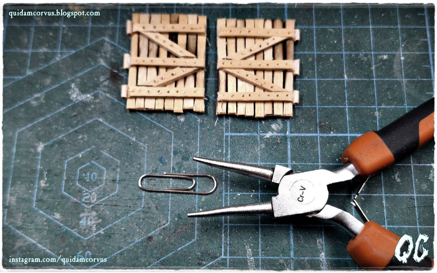

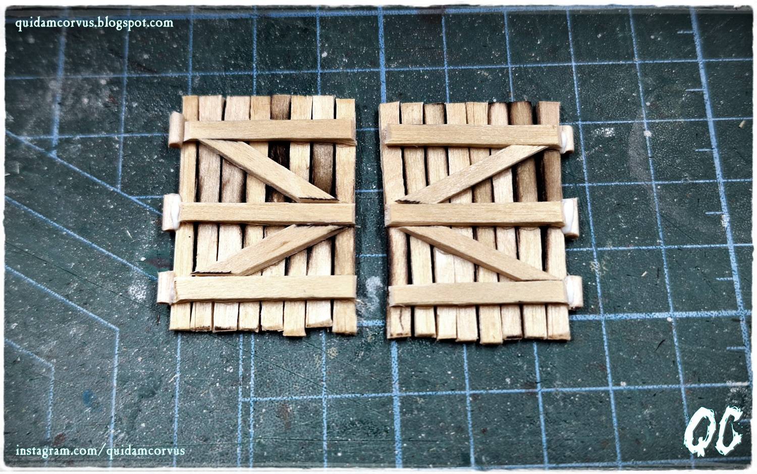

Today I have a short guide for you, in which I will show you step by step how to make doors from coffee sticks in models depicting the ruins of Mordheim.

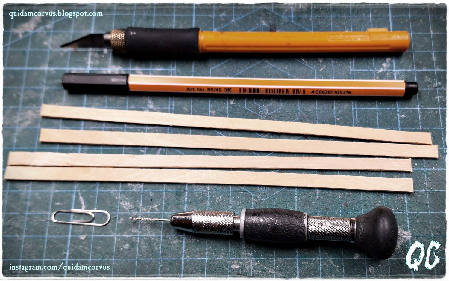

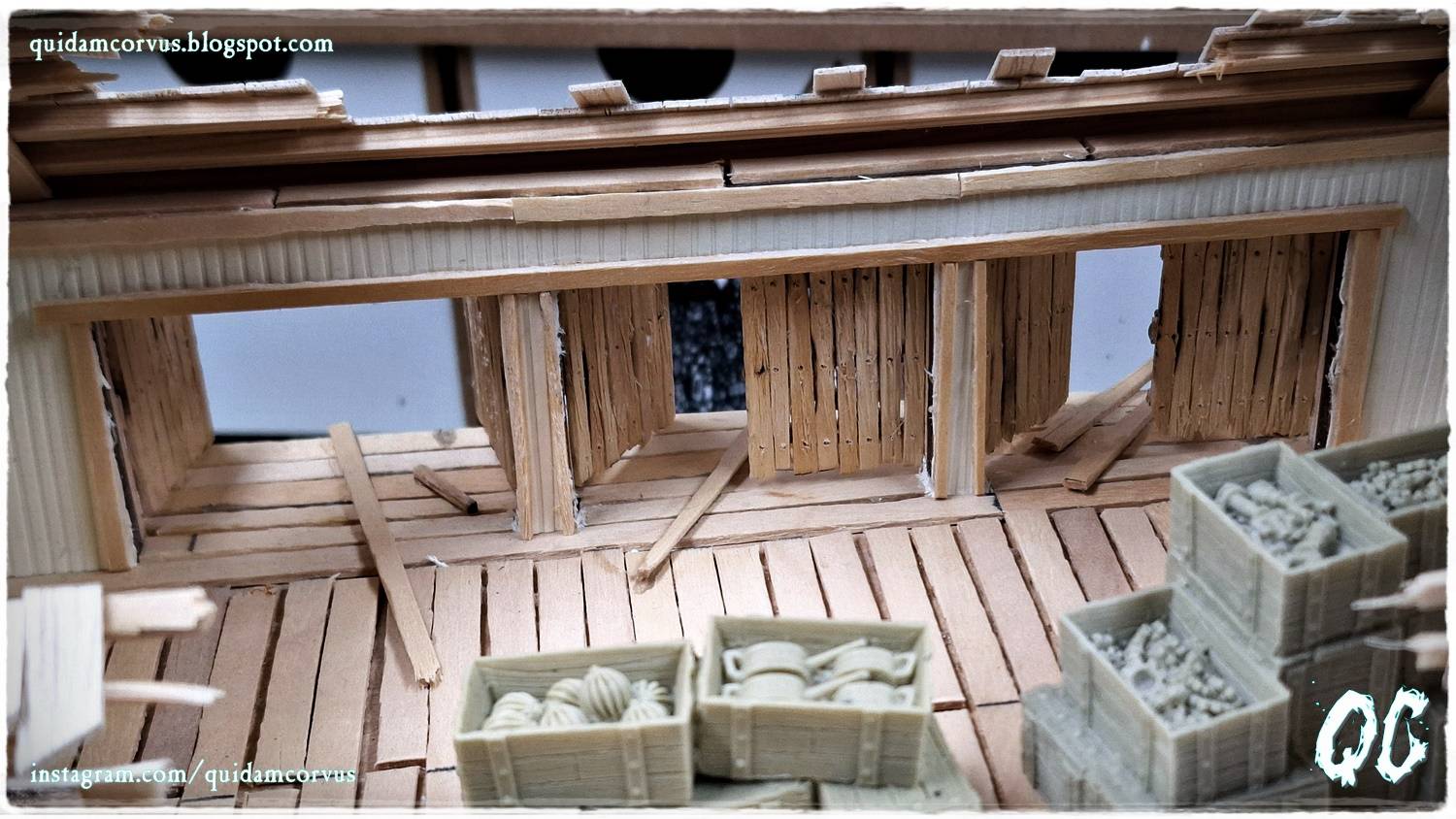

To make doors and shutters you will need a few coffee sticks or other thin wooden strips, a sharp knife, a marker, a hand drill, as well as a paper clip, wood glue and cyanoacrylate glue.

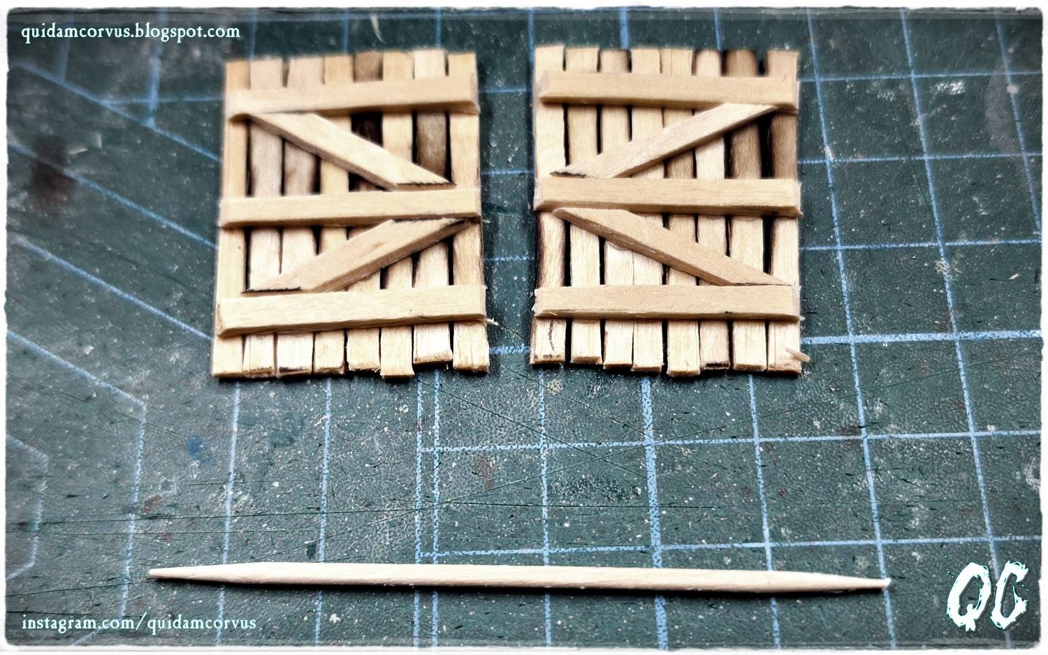

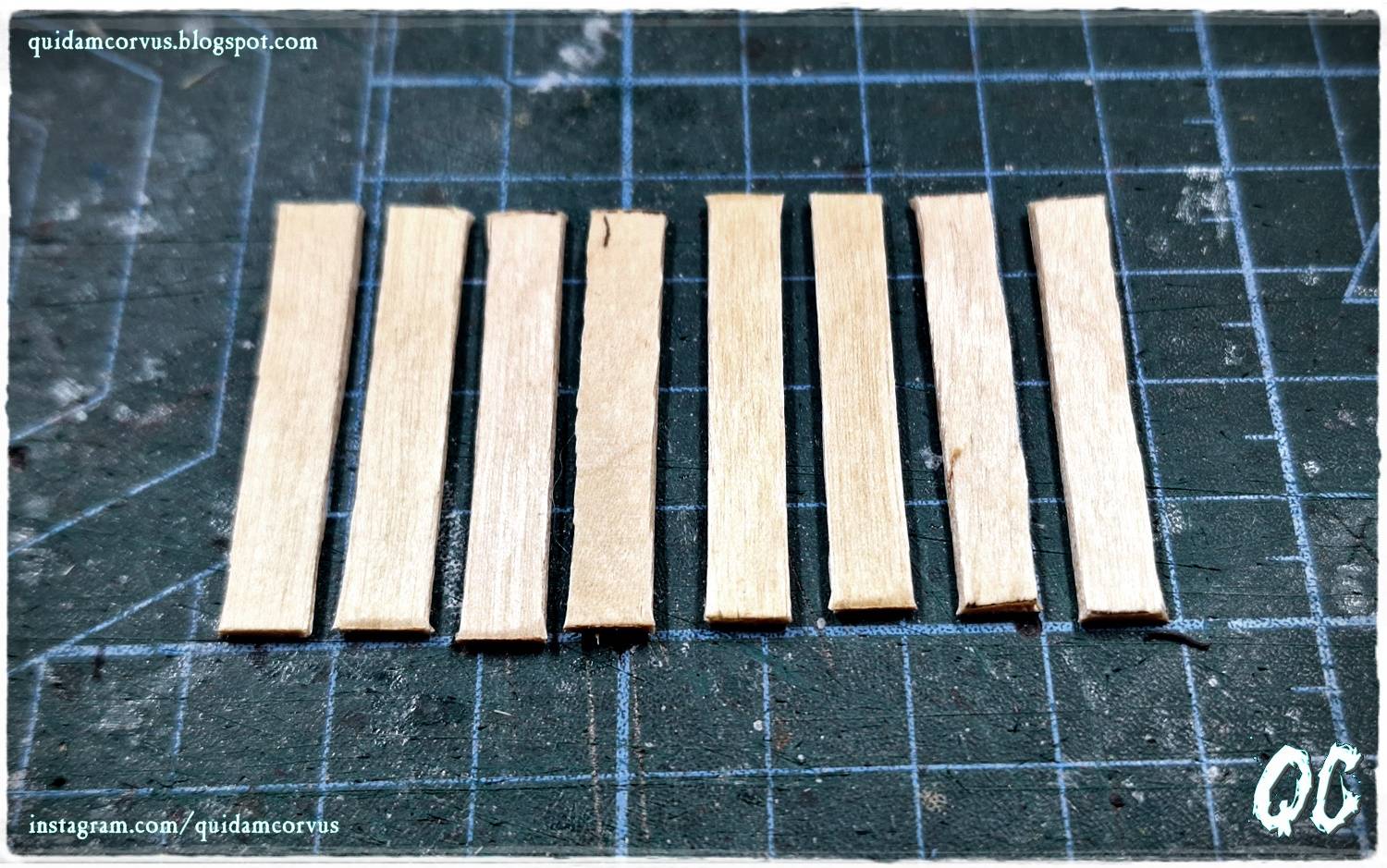

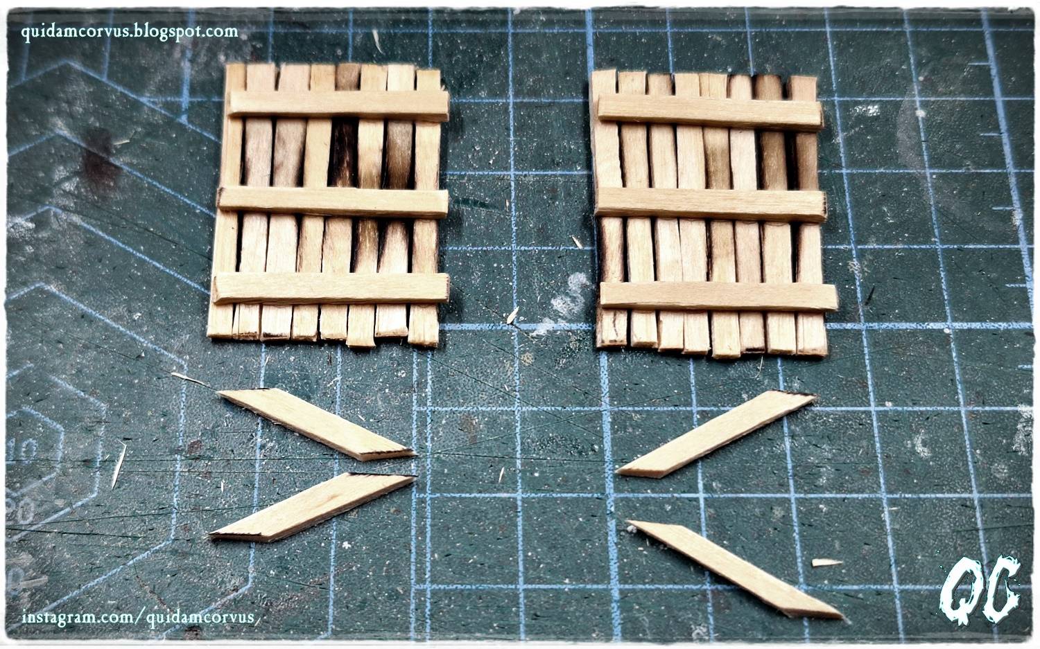

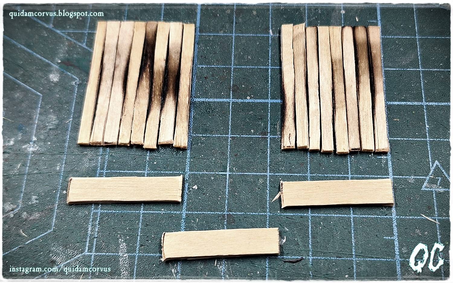

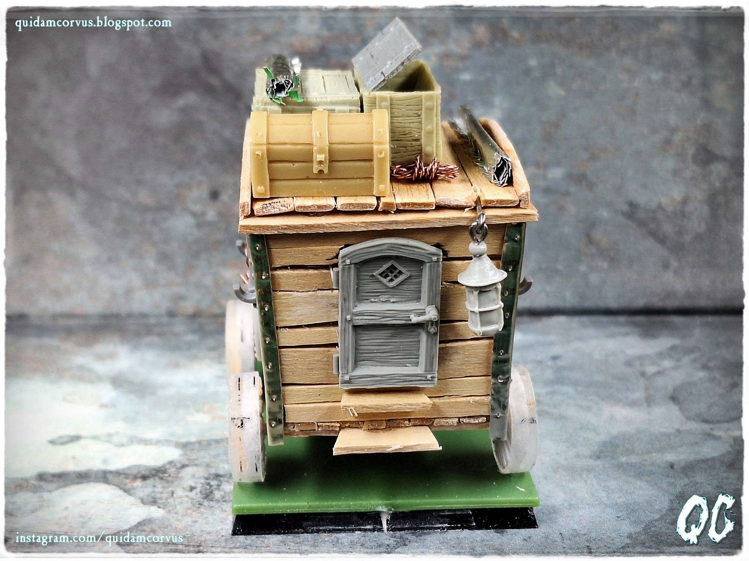

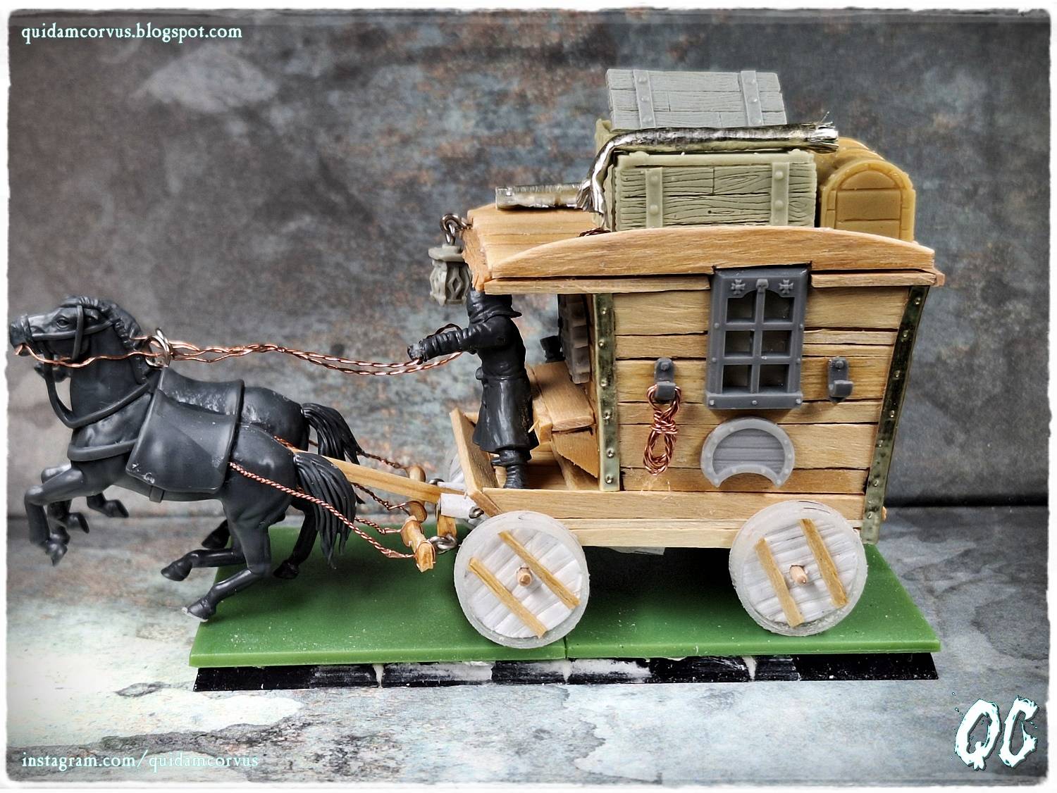

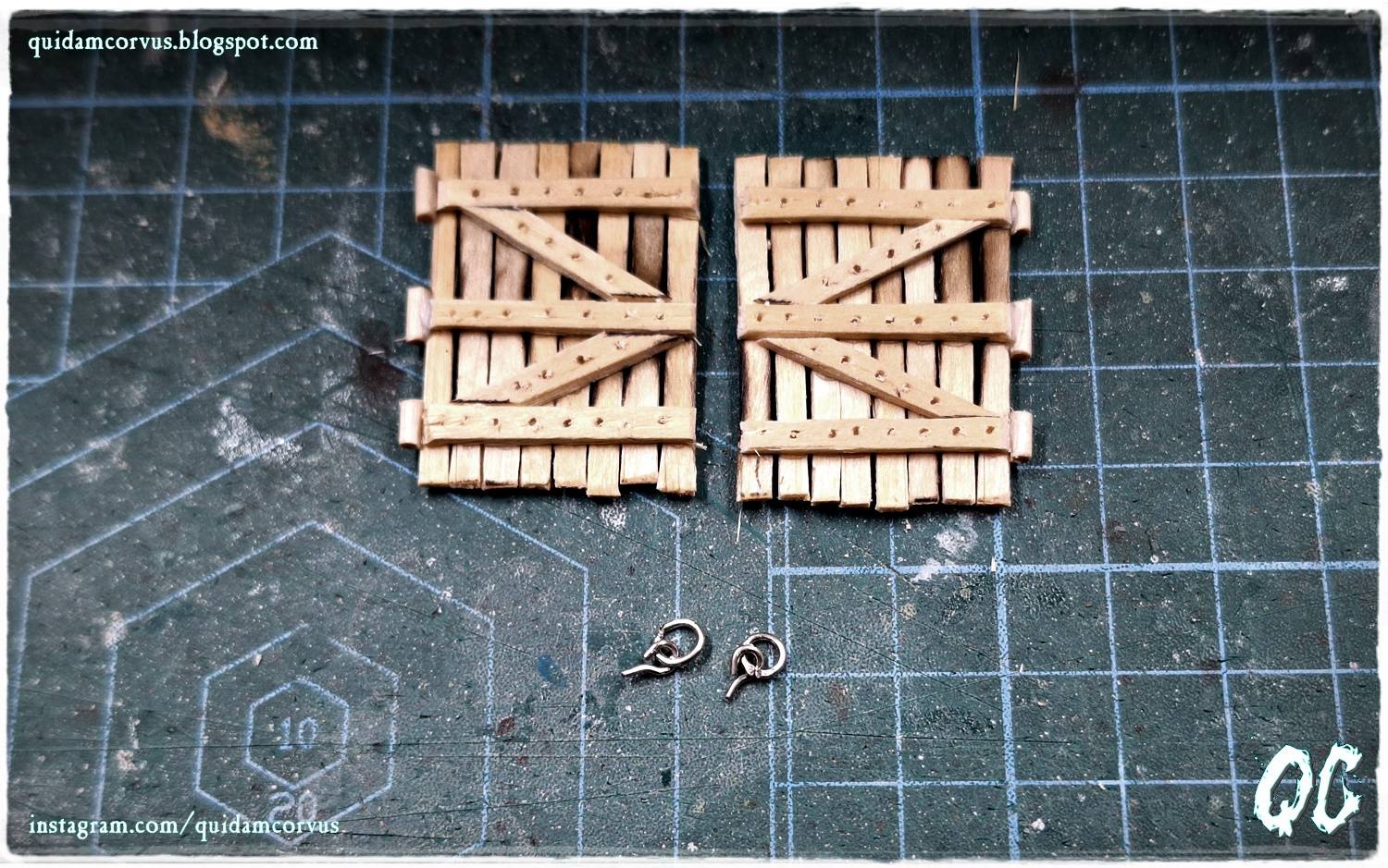

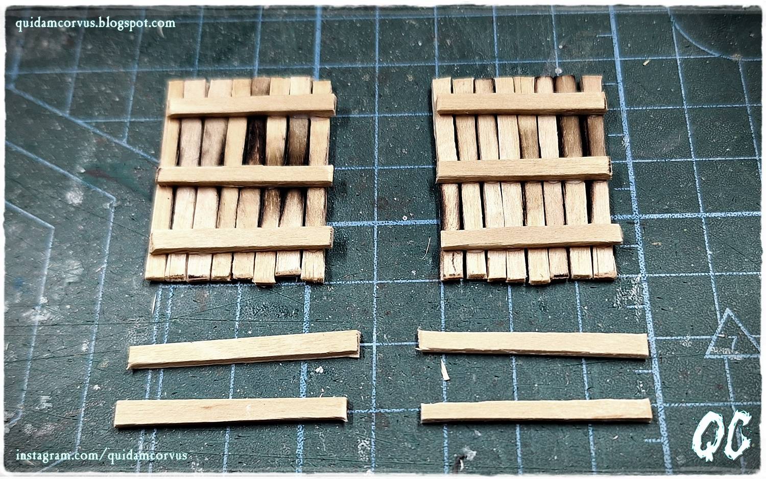

I started working by cutting coffee sticks to a length equal to the height of the door.

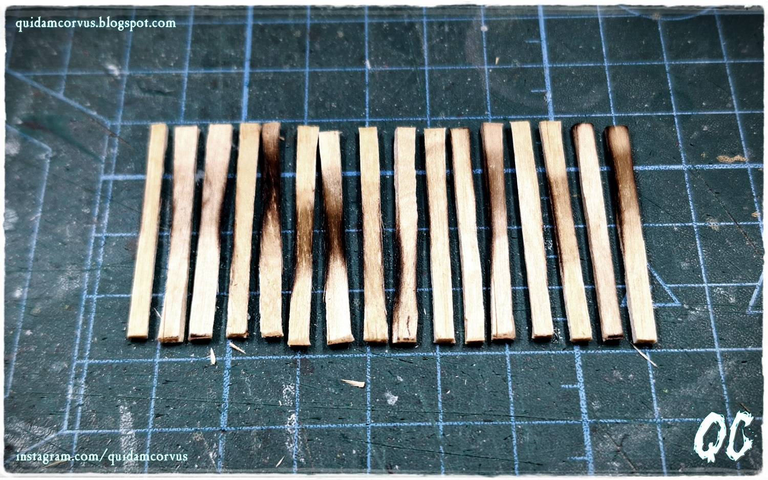

Then, using a sharp knife, I cut the fragments lengthwise to obtain narrower slats.
If you want to age the door, be careful, you can, for example, use a lighter and burn the cut slats with a flame.
If you decide to take such a step, be careful and prepare a container with water to extinguish the fire.

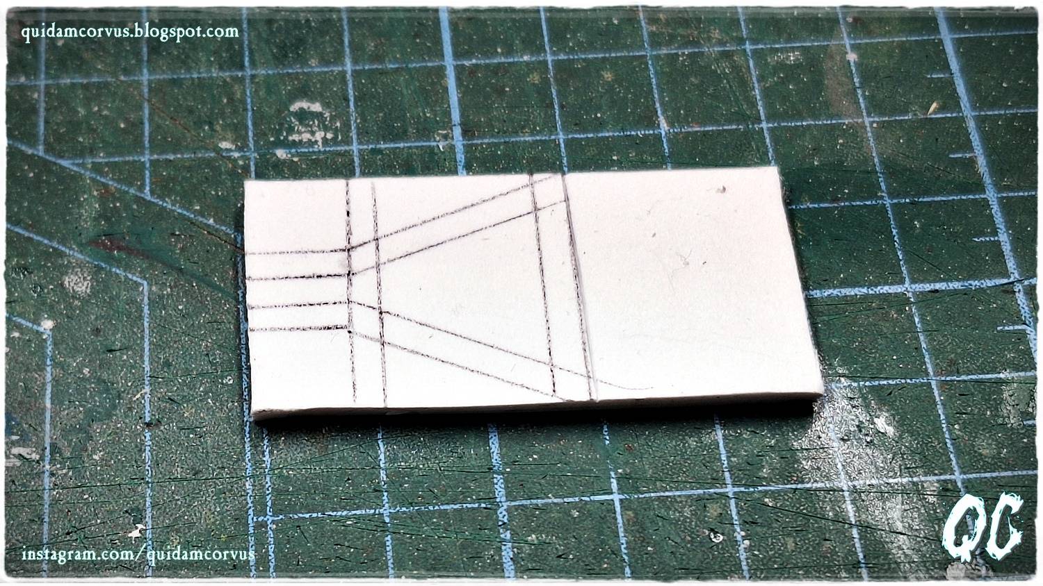

In the next step, I cut the coffee stick into sections whose length is equal to the width of the door.

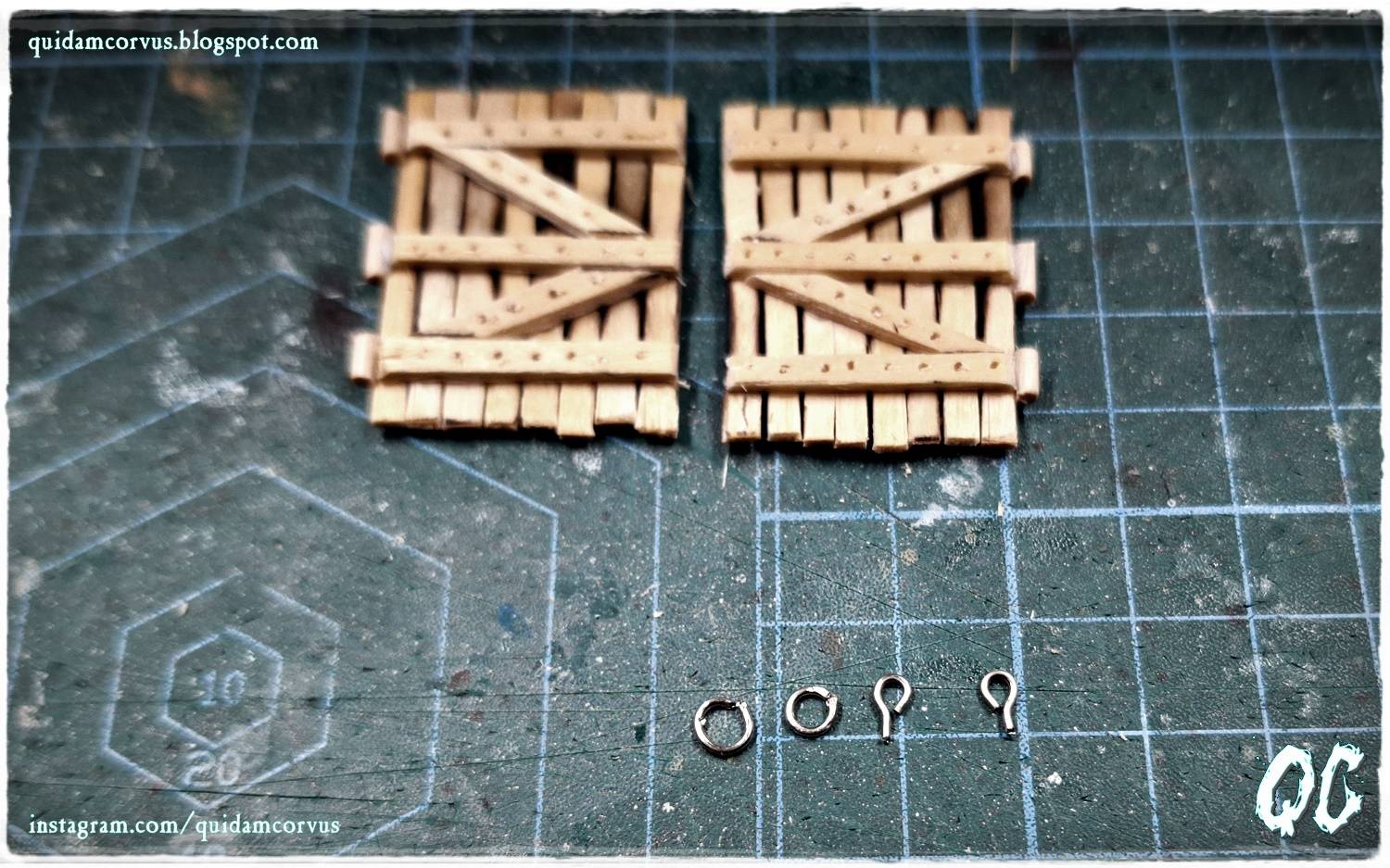

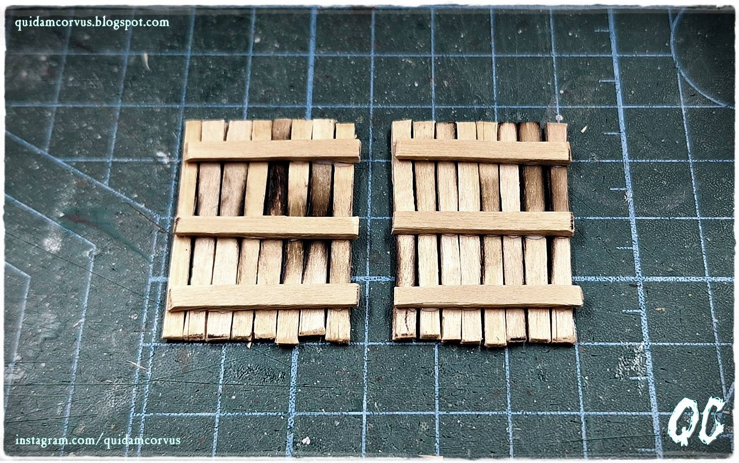

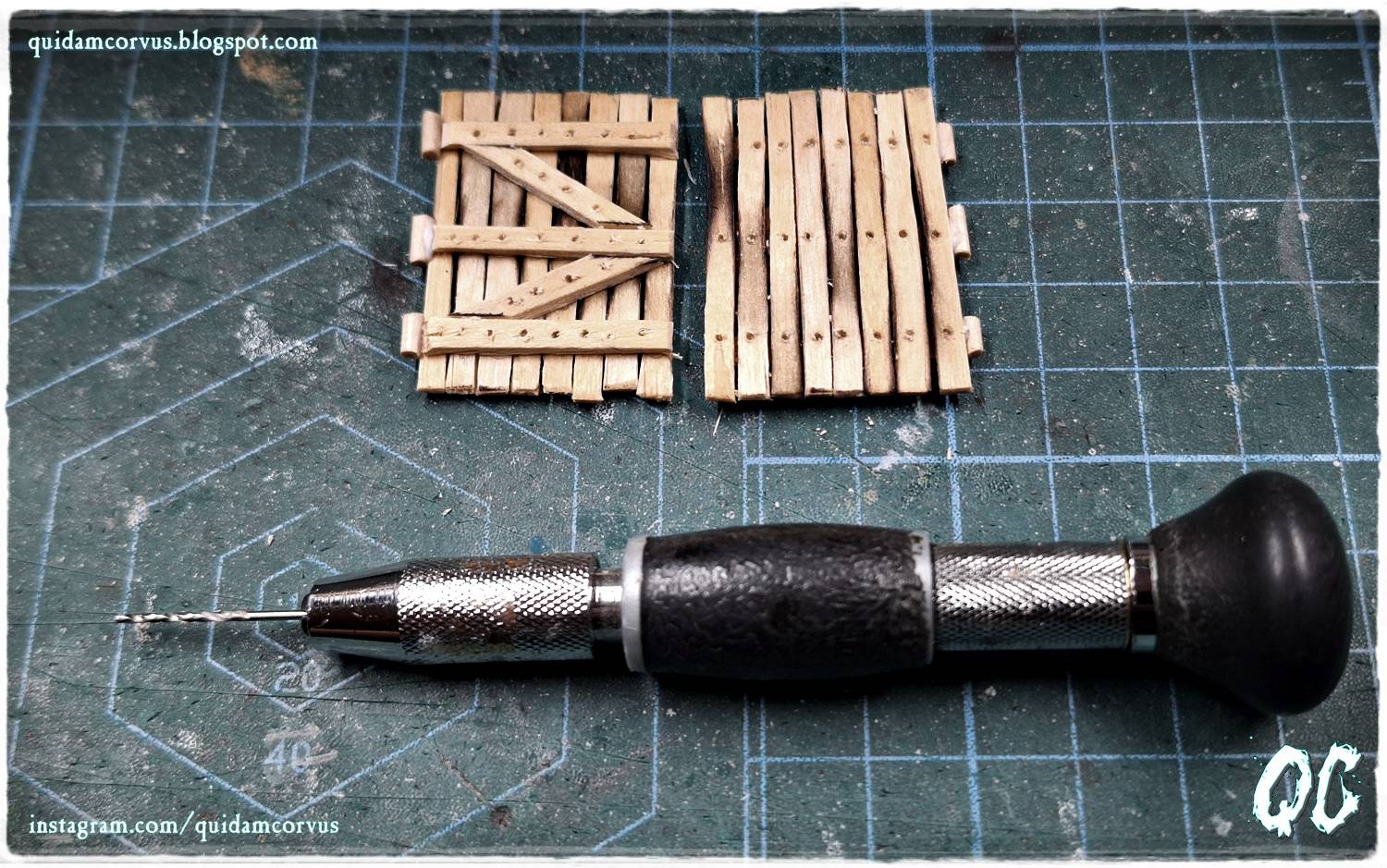

I cut the fragments obtained in this way lengthwise to obtain narrower slats, which I then glued with wood glue perpendicular to the vertical slats.
Then, from the previously prepared narrower fragments, I cut out further fragments and glued them with wood glue at an angle between the previously glued horizontal beams.
To make imitation hinges, I used a toothpick cut into pieces, which I forgot to mention earlier, and glued them with wood glue.
Then, using a thin drill placed in a hand drill, I drilled holes in the previously glued beams imitating the places where the nails should be placed.

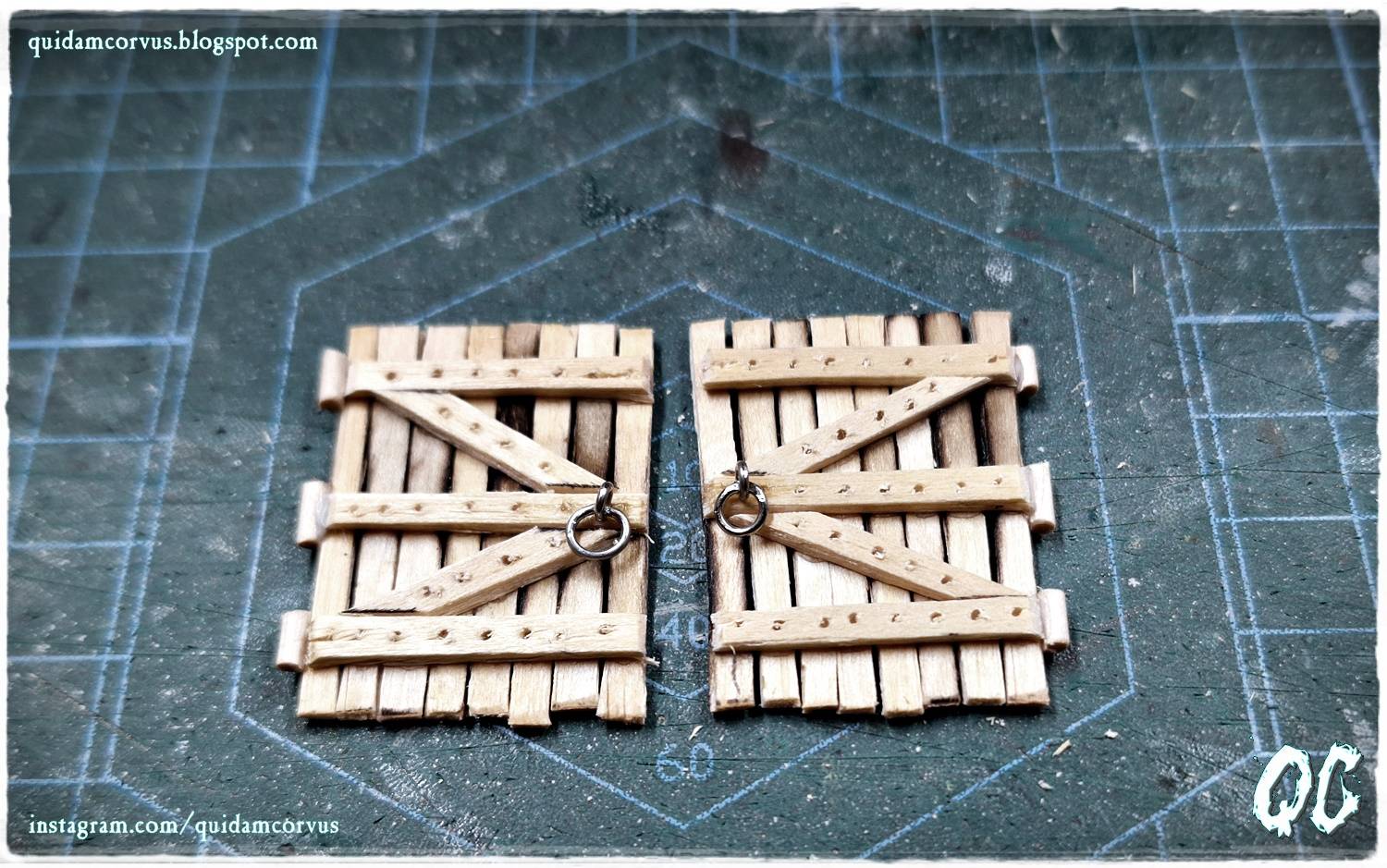

Then, using tools, I made door handles from a paper clip and glued them with cyanoacrylate glue in the holes drilled with a hand drill.
And I placed the doors prepared in this way in the frames intended for them, located on the models.
