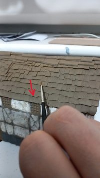

When I dry brush I gently 'stroke' or 'pull' the brush down its length and then wash it as normal.
This is a terrible way to show how I do it:

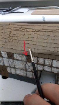

For scale reference:
