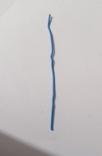

I want to drill out a banner pole (lead, broke of course) and replace it with a paperclip as a banner pole, but I need to drill out the pole first and I think electric is the way to go.
On a personal note I can't see any situation in which I would use an electric drill over the manual one I have.
They would be heavier and less easy to manipulate and it would be easy to slip and make a right mess.
The only time I would consider using an electric hobby drill would be with a cutting disc attached for removing integral cast on bases from models.
What makes you think you would benefit from a leccy one?
PS: Paperclips only have really short straight sections, if you are looking to replace the entire pole (I assuming it is 30mm or more) then a brass or metal rod would be best?
It would be a lot of faff to properly straighten this out?
I mean obviously do what you think is best, you know your own business way more than I do, but electric drills and paperclips for replacing a banner pole seems like woes to me.
Oh, I can think of a few times my Dremel has been a much better option over hand. Mostly on chunkier figures.
Though for a small stuff like a hand.. no chance.
Paperclips are fine. I wouldn't use a plastic covered one like that but apart from depending on the size of the clip, there are some pretty simple ways to deal with making them straight with bending, heating or rolling. though getting some cheap rod or flower wire probably better
