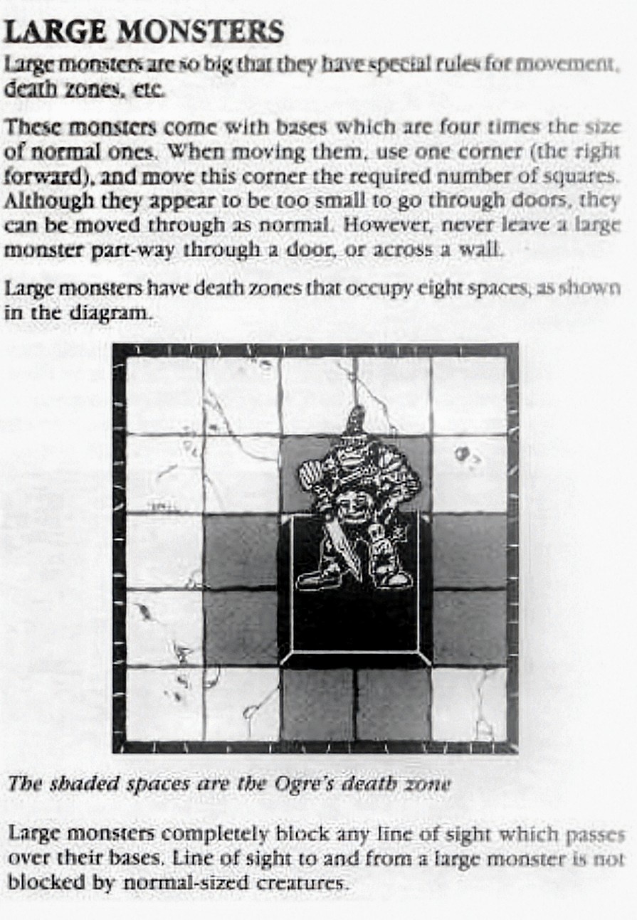

AHQ rulebook page 40
For HQ'89 or WQ'95 if I can, I tend to base a few big monsters on 25 mm and create 40 mm sub-bases when I want to play them in other games.

makes sense AHQ did rules for larger bases..
