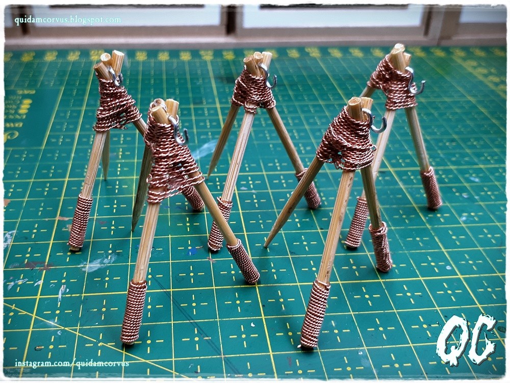

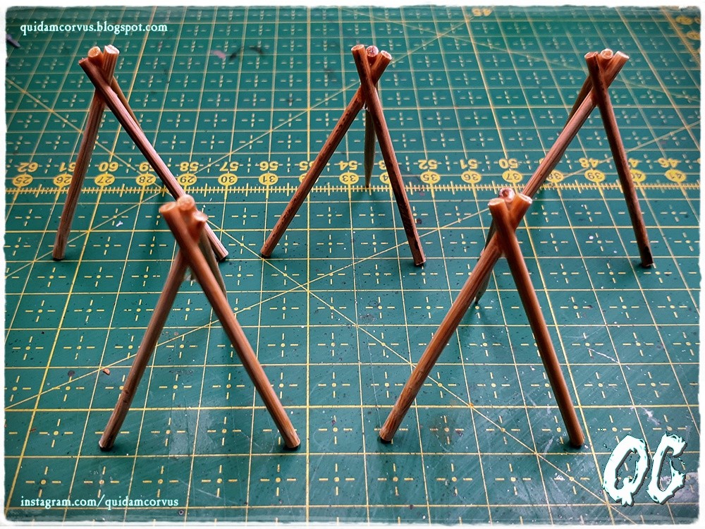

Skewer sticks cut into 5 cm sections, three for each shooting target, from which I will build a tripod stand. Then I cut two of the legs of the rack at the joint and glued them in a V-shape.

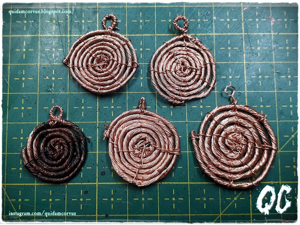

I put the sticks to dry and in the meantime twisted braids of different thicknesses from copper wires, which I then rolled into a spiral.
In the next step, with a single wire, I twisted the arms of the twisted wire and made round handles - the latter finally turned out to be unnecessary and were cut off.
To strengthen the whole, you can soak with a few drops of cyanoacrylate glue.

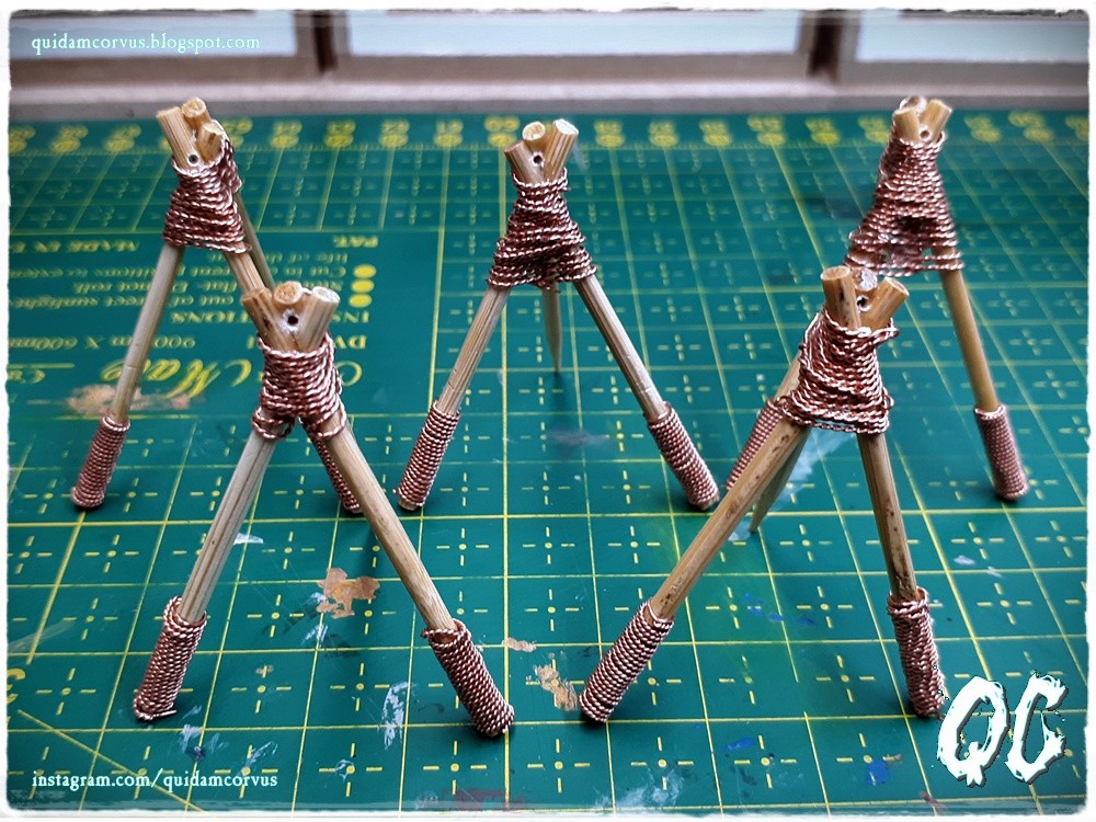

After the glue drying the first two beams, I glued the third leg of the rack, and then wrapped selected elements with a rope made of tightly twisted two copper wires, which I also strengthened with a few drops of cyanoacrylate glue.
The time has come to mount the shooting targets, for this purpose I drilled holes in the rack, in which I placed hooks made of paperclip.
I decorated the tops of the stands with bits of banners.

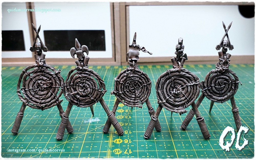

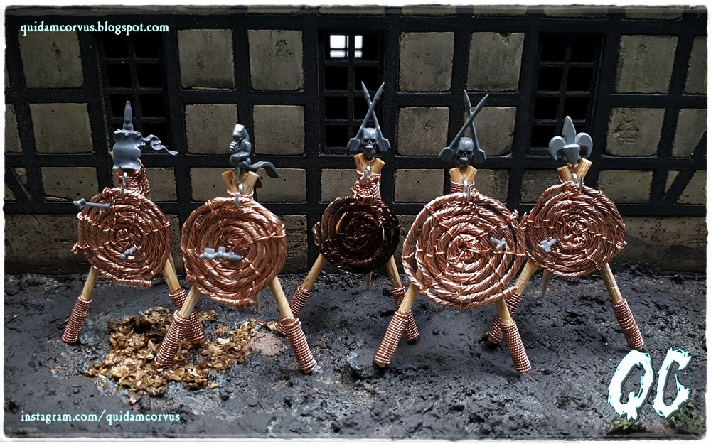

And the last step, i.e. fixing the shooting targets on the stands and painting the whole with primer paint.
