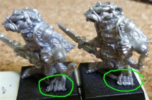

As much as recasters are loathed in certain parts, Citadel could have done far better outsourcing their operation as the results were pretty poor. Here are but a few examples I drummed up:
Who needs toenails? This is just the tip of the iceberg here. Most of the armor detail & Skaven features are soft to the point where a painter would need to redefine them.
Note the shrinkage in the new cast, thinning of detail, & what exactly happened to that sward?!
The resculpted sword is ok compared to my battered original, but there is still detail lost in the hilt & the '93 version is definitely smaller.
On another note, I've noticed U.S. minis out of the early 90's age worse than their lead counterparts & develop discoloration along with a patina. Easily fixed with paint, but the qualitative difference in the pre-'93 minis stands.

I can fill in a little detail.
The lead ban issue of 1993 was very real and very scary for the industry. It originated in New York but it was easy to see that if New York passed the law then other states would move to follow. Add on to this the growing issues of lead in the EU and you have a problem that was coming on very quickly.
Games Workshop worked with Grenadier, Ral Partha, Rafm and others to hire a legal team to get the proposed legislation defeated. At the same time the entire industry in North America saw the handwriting on the wall. Most manufacturers immediately began dumping lead production and moved to find an alternative. This happened around April of 1993 as best I can remember without consulting my boxes of papers.
Some companies, like Ral Partha, experimented with early resins and plastics. Most, like Games Workshop, began looking at an alternative metal that was easy to cast but without the toxicity of the existing lead.
I know the person who led the team to try to find the right metal. He's genuinely smarter than most people and a great deal of work was done finding something that could use the existing molds. (The alternative that went into production was what you are seeing here in some of the pictures.) Alloy that was rejected by Games Workshop went into production with at least one company that I know of with results that were grim.
At the same time Games Workshop's existing code ranges were very, very large. The problem of moving from lead to non-lead gave the company a way of simplifying the range for trade accounts and eliminating some of the miniatures that were, I know this pains many of you, slow sellers. This is where the four rack systems at the time came from. It allowed a store to have an easy to restock, simplified wall of product.
Unfortunately the racks sold well. Very well. Beyond wildest dreams well. This caused a second crisis: Production.
At one point the Baltimore foundry was running three shifts to try to match the production requirement. I started with Games Workshop shortly after this and can tell you that a lot of people were very, very tired after that summer. The new metal required larger vent lines which, if not drilled out or cut properly, led to the loss of detail you can see in the skaven in the picture. At the same time it poured differently from what I can remember hearing. It was also an unprecedented demand of the new alloy.
As the system shook itself out the quality of the castings got better and better. The warp spiders from the following year were very, very solid production castings and by that time the kinks had worked themselves out.
