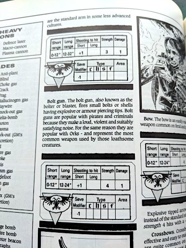

Your copy might have a misprint, or it's easy to muddle it because the Autogun table is above the Bolter entry, but the Autogun description is at the bottom of the previous column. In my copy of the hardback RT page 70 a Bolt Gun is S4, D1 with a -1 save modifier. Same in the softback. Those match the stats on the summary card at the back of both books. The Battle Manual page 44 is the same as is its summary card at the end.
(from the softback)

On p.70 of my hardcover version of RT, the stats for Bolter and Bow have switched places. One is where the other is in your pic and vice versa.
It all makes a lot more sense now.
Again, thanks!
Interesting. It's correct in my hardback which says it is the 'second imprint' and we know the first printing was correct (thanks Zhu), I wonder when they made the mistake? Is yours an old copy or the re-released reprint they did a couple of years back at Warhammer World?
