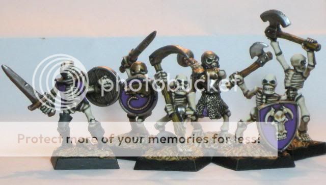

For plastics, which are mostly bones, I keep it simple.
* Black & white zenithal undercoat.
* Minor pure white highlighting on topmost surfaces.
* Brush on dip of mixed Polyshades Tudor Satin/Antique Walnut on bone surfaces.
* Re-highlight as needed with thinned pure white.
* Paint the other bits & brush on Dullcote.
I also go back in and, after re-highlighting the teeth, black some out. How all those "Medieval warrior" skeletons got such nice sets of teeth was always a mystery to me. :D
Haha, fair point.
But, the medieval Welsh were know to clean their teeth often with hazel twigs.
Everyone else in Europe were a bit dirty though.
Some of us still are, fluoridated water and orthodontists are for Americans :)
Nnagruz - I love those pics. The glowing eyes are tops!
Can you share the technique you use to get that great oxidized green copper? It looks magic.
Thanks! :D
Basically, it's similar to what I did in my pigments thread for verdigris HERE.
Brassy/copper paint underneath, apply dry pigments (white, turquoise, green-blue), fix with turpentine, & then rub off some of the pigment in select areas with a damp brush. I also stippled in some greenish-brown oil paint & blended that out with a damp brush (damp with turps) as well.
