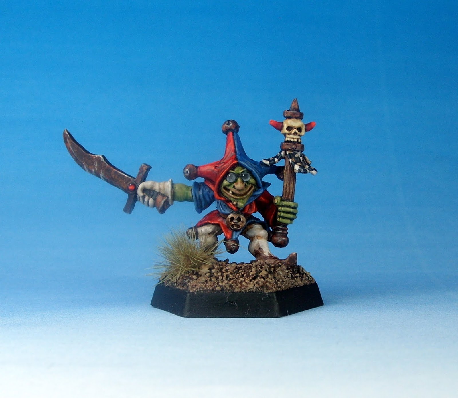

Thanks for the input. I'll have to get some of the specific colors mentioned here. I'm pretty pleased with my first effort, but wished I'd had a more pink flesh tone.
I do think this style nicely breaks up the face:
Niibl
Well done. If the contrast is too strong between skin and lips for your taste, you might experiment a little bit with inks (pink, flesh or purple). But I would try it on a test model first. This one is too nice for such experiments. BTW, I like the yellow tones as well.

Thank you kindly. I'll continue to play around with this technique, though I'll do so on other models indeed . . .
