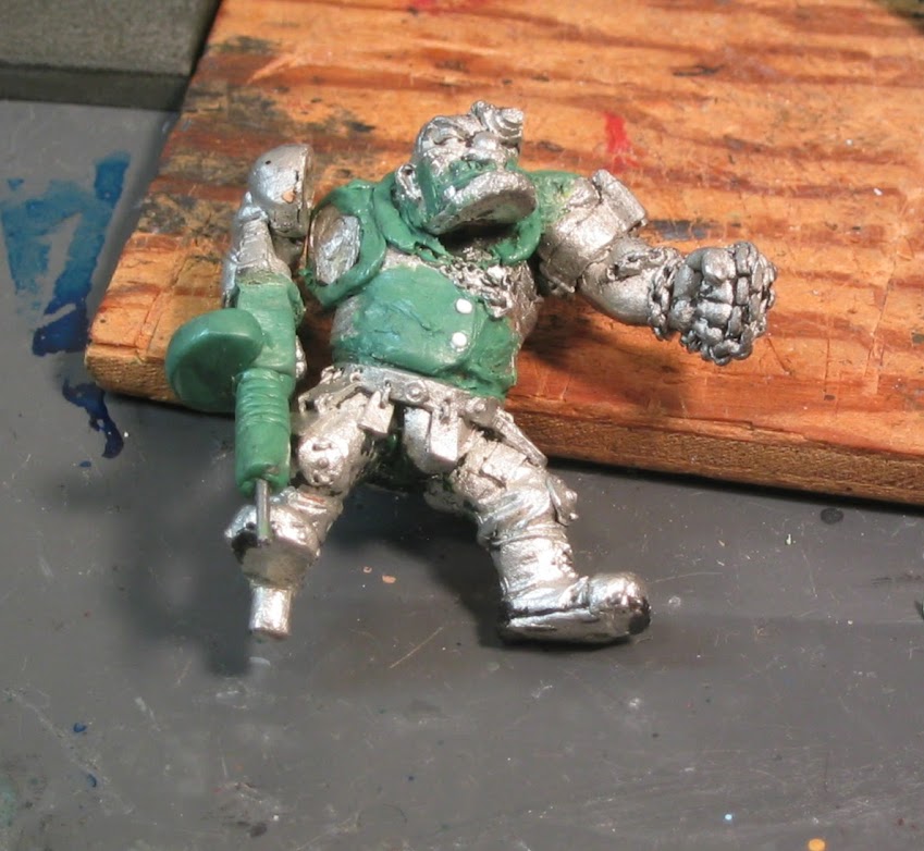

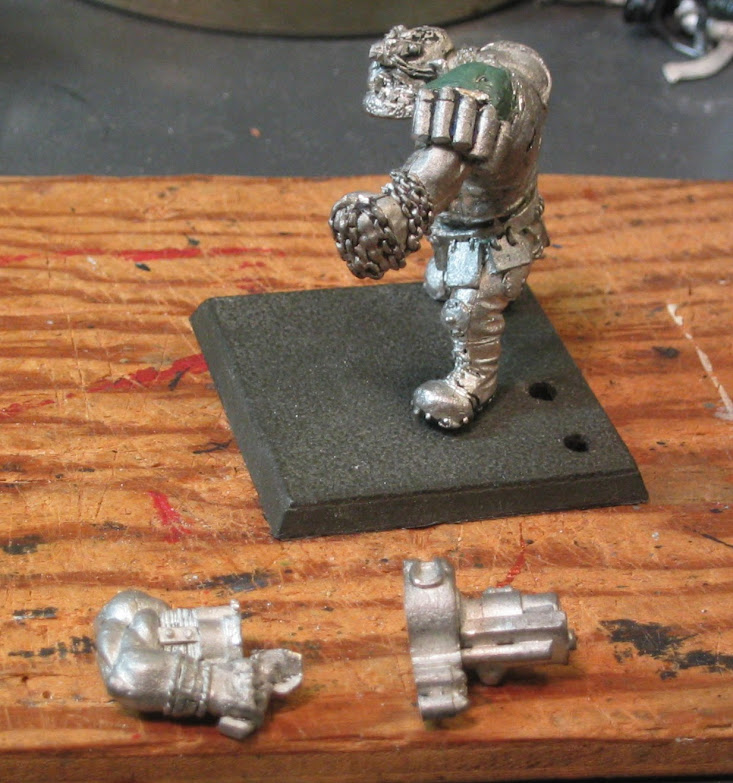

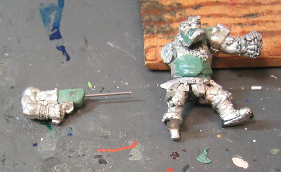

After which I began hacking it apart and gluing it back together in different ways. You can see I cut up the ripper gun, since it's so very different from the current one. I also hacked his left arm off with a saw, the better to reposition it and sculpt up a new shoulder . . .
(Can't have two miniatures with that same fist pump. Maybe can't have any.) Here's some more photos of the kneadtite surgery . . .

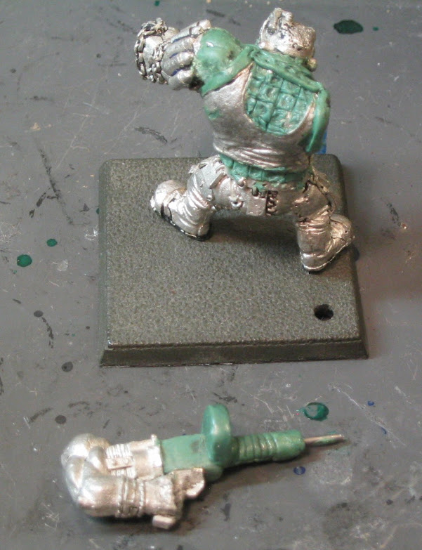

At some later point I also removed half his teeth. The fangy Ogryn just didn't fit with the older Olley slightly dopey aesthetic. Next I decided the undershirt was a non-starter and began converting it into a vest. (I also added lips and one slightly more round protruding tooth.) . . .

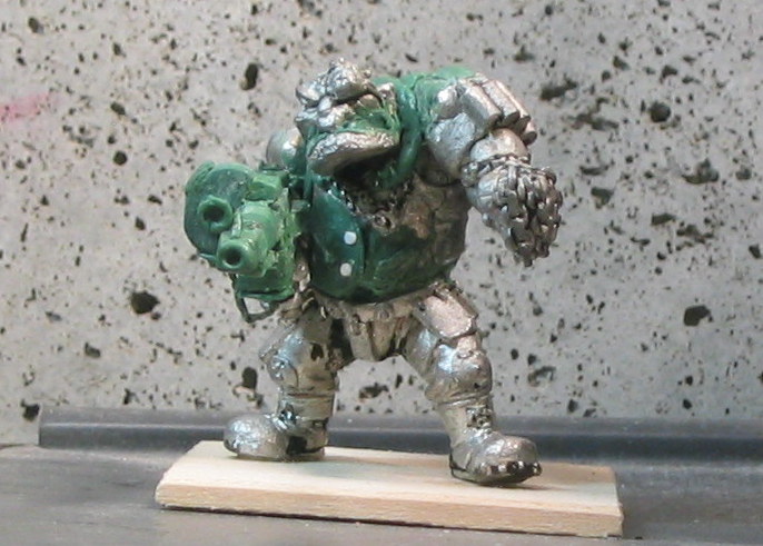

And I started building up an older, more delicate ripper gun on the butt of the newer one. (If you can call a gun an inch and a half long gun the size of a telephone pole delicate.) As I started getting more adventurous I added a padded oldhammer style flak jacket . . .
And buttons and pockets to the vest and more gun . . .
We've got a little further to go yet, but I'm starting to enjoy this green stuff.

Also, I've made some progress on the ripper gun that uses at least a little of what Niibl suggests, though without removing the magazine or introducing other materials (as I have only sculpy, which seems nigh on useless) But I've filed and scraped, and I'm slowly adding more details that will hopefully make it feel more technical. Thus far I've an extended gripping area to the bottom of the barrel, a small vent to the rear (Maybe it's a recoil damper? Who knows. Obviously not enough of a gun guy. This requires study.) . . . and some buttons to the side. Smart gun tech for your Ogryn troopers. Even the original Olley sculpts have a little of that. More will come. Sights, a flash suppressor, maybe a belt coming out the bottom of the magazine and feeding into the gun (which seems a little silly, but it's on the original and it looks good enough. Maybe gun guy technical stuff can take a back seat to reverent mimicry.)
