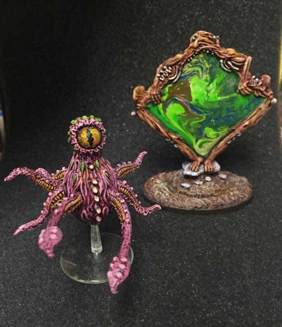

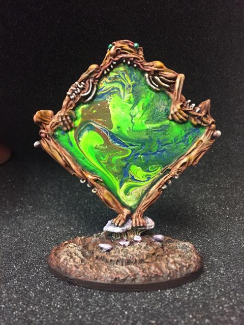

Great colours on the gate - what’s the trick? Oils?
An acrylic pour! I’d never heard of this before my wife suggested it as I mulled over how to address the large flat “portal” area.
You can find a lot of YouTube videos of people using this technique on canvass.
Here’s how I did it, and some notes on what I would change in a future effort.
Acrylic pour:
1. Paint the flat surface white or black (I did white).
2. Get a suitable container to pour from. You’ll have to build layers of paint in it. I used a small mouthwash bottle cap.
3. Pick four paints. One should be black or white. Ideally of similar density, I didn’t do that but in retrospect it would have improved the look. Ideally use dropper bottles.
I used white, scale 75 fluorescent green (I think this paint made the look!), festering blue, Vallejo blood red (would not use again, it mixed too much with the blue and photographed too brown).
If I were doing this again I would pick brighter colors.
4. Layer the paints in the container.
5. Hold the flat surface to the top of the container tightly.
6. Flip over. Hold tightly.
7. Wait 30 seconds. Lift off the container and allow paint to spread out.
8. tilt the model so the paint flows to the edges of your flat area. You can use the back of your brush to create swirls. But be judicious! You can muddy it into brown by doing this too much.
9. Carefully, let it dry flat.
One tricky thing is eyeballing how much paint you need to cover the surface without looking at the edges. I don’t really have a tip here. If you’re doing this on a surface that excess paint can just flow off of, so much the better

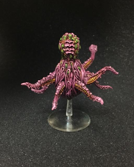

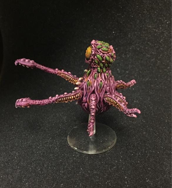

I’ve now painted the tentacled monster that came along with the gate.
Positively boss!
And, okay, the cap trick is in fact how she does her acrylic pours. I just didn't understand it. Whoops! :">
Someone posted a really cool animated version of a gate much like that. Was that you? The swirls swirled. Anyway, I love your beholder/enslaver/tentacled best. Fantastic!
Awesome O_O !
