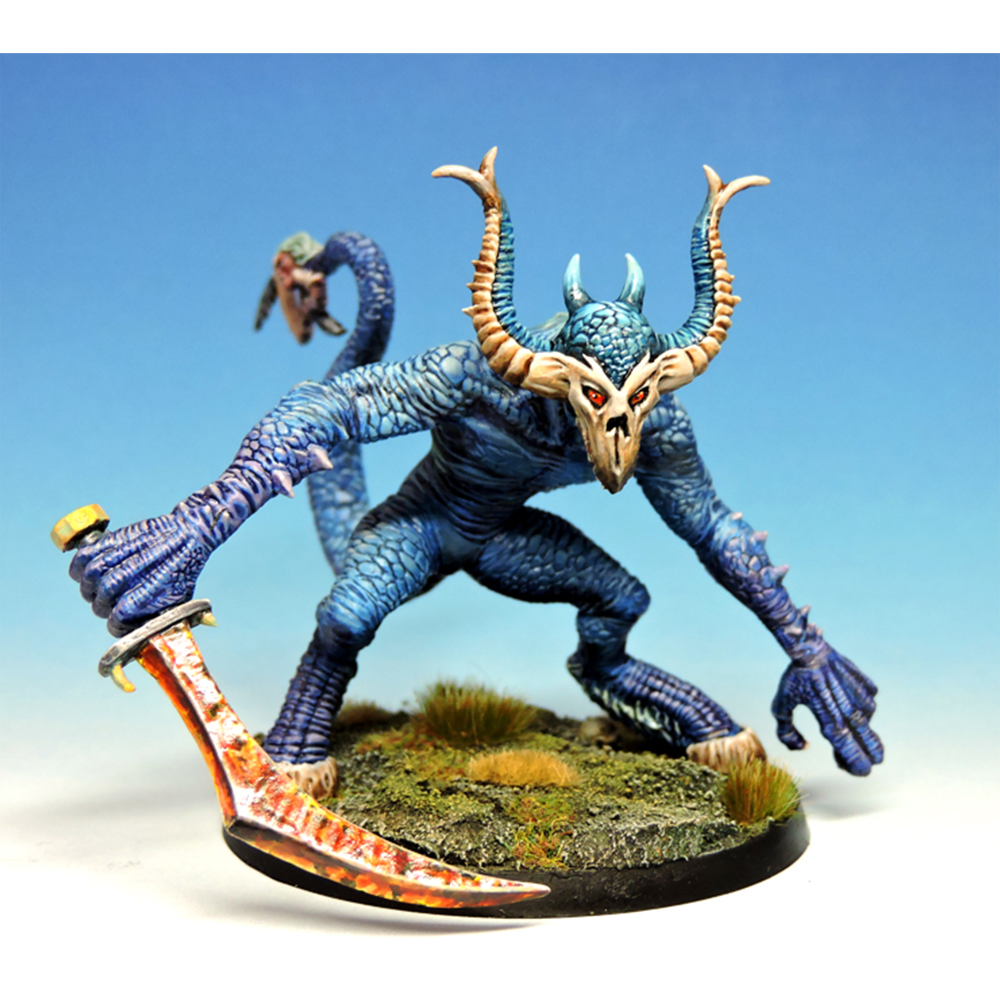

My project to finally build and paint my Knightmare Games Pantheon of Chaos minis has reached a critical stage. I have at last got up the courage to build the larger pieces including the Demon Lord of Malice ( which we all know is really the Greater Demon of Malal but we won't say that will we ?).
So clearly this will require much serious pinning and gluing. I intend using Gorilla Superglue as it works well on smaller/ medium sized pieces but I wondered about applying accelerator as I have never used it before. Any advice on whether it iseffective, alternatives like baking powder? Thanks in advance.
