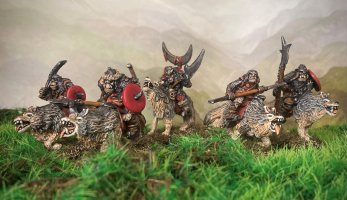

Fur has often such a nice texture that I find that one can get away with just a single Contrast color in order to make a quick and easy paint job.
Some recommended colors:
Brown:
  • Gore-grunta Fur
  • Cygor Brown
  • Wyldwood
Tan:
  • Snakebite Leather
  • Skeleton Horde
Grey:
  • Basilicanum Grey
These can just be applied right out of the pot. If one want to add even more variety one can just drybrush various matching colors on the very edges of the fur.

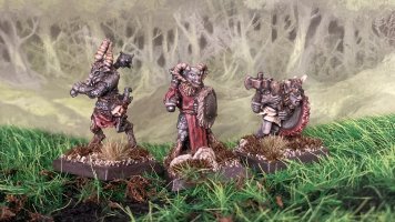

I found an old picture of some A Song of Ice and Fire miniatures that I speed painted some years ago by using the colors described above to paint fur. Note that the wolves though have been drybrushed with a lighter grey to make the their fur pop even more.

For Beastmen I could also recommend going with a black color for the fur. I use Black Templar, and then a grey color to drybrush for some highlights.

The owlbear and chums look really nice. My beasties have greyish skin (as a homage Bryan Ansell's beastmen collection), and I think black fur might make them a touch monochrome. That black and orange really pops, though.
