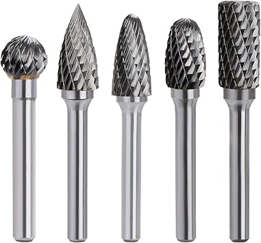

I'd suggest picking up some small metal grinding burrs for it. they work a bit better than the hard stone type grinding tools.
This sort of thing:
but obviously small enough to fit the dremel, I think that pic is some larger ones, but you get the idea.
