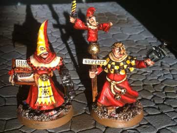

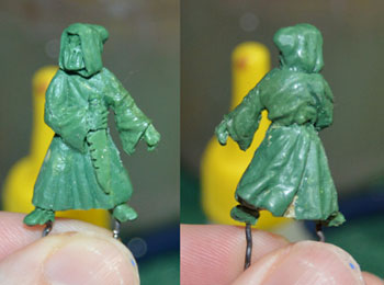

An exciting moment for me, as I painted my first homemade figure. I sculpted the green, and then at the weekend I made a silicone mould and cast a number of them in metal with some rather mixed results. This was one of the successes and he has now been painted up. (Sorry about the photo quality - it was taken with a phone under a desk lamp).
I originally started him about ten years ago as a cultist to go with the now unavailable range from Babylon's Burning, and he sat in a box until I came home from BOYL fired with enthusiasm for a bit of sculpting and finished off his robe. I also brought back a load of monks from their special offer odds and sods cabinet, and I have been converting these into a Redemptionist Necromunda gang (a couple are just visible in the background), and with his robe and flamer he fits in nicely.

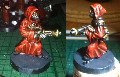

Thank you for the compliments. I'm pleased to confirm that he already has a couple of friends with a couple more in progress. I'll post some pictures.

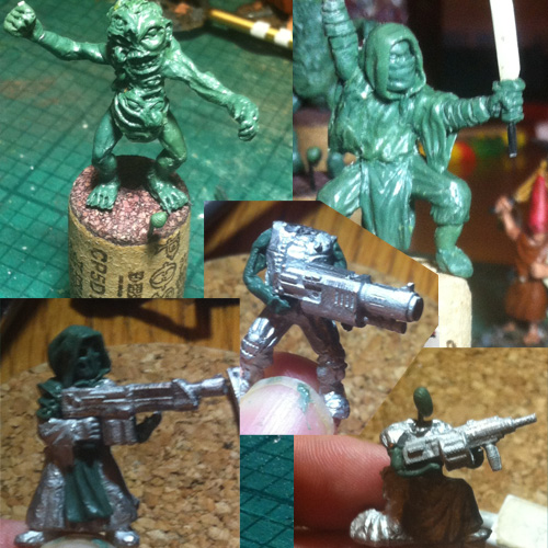

Sorry to bump a a old thread (Well ok I'm not sorry hehe) I just ordered the set of these.. can't wait to get them. Can I recommend making some with huge axes and chainsaws kinda like not-redemptionists (Yep that's what mind will be).. Oh a grenade launcher would be nice too heh :grin:
Thanks for the feedback (and the custom) Chico. I've just posted a WIP shot of some of the next batch on the blog.http://www.warfactory.co.uk/wp/2015/03/25/wip-sculpts/
If you look at the model on the bottom right, you'll be pleased to see he is toting something a bit heavier. I'm trying to decide what to do for his head - options are:
  • Another mask and hood
    A more pointy inquisition style hood (not sure about this, because he is pretty big already and this will make him look even bigger
    Some kind of mask such as the redemptionist below on the right.
