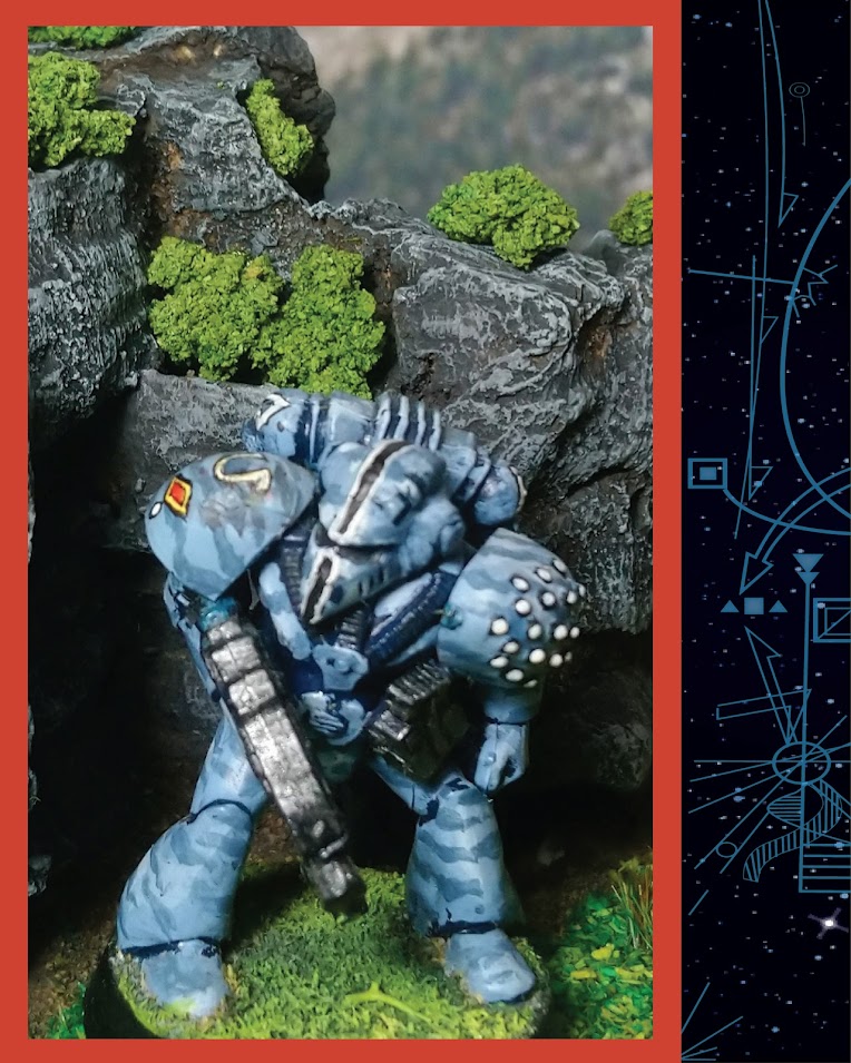

I think there is photo of old marines with that blue camo?
https://scratch-that.org/2021/09/04/sho ... ettlewood/
Nice minis on the page.
